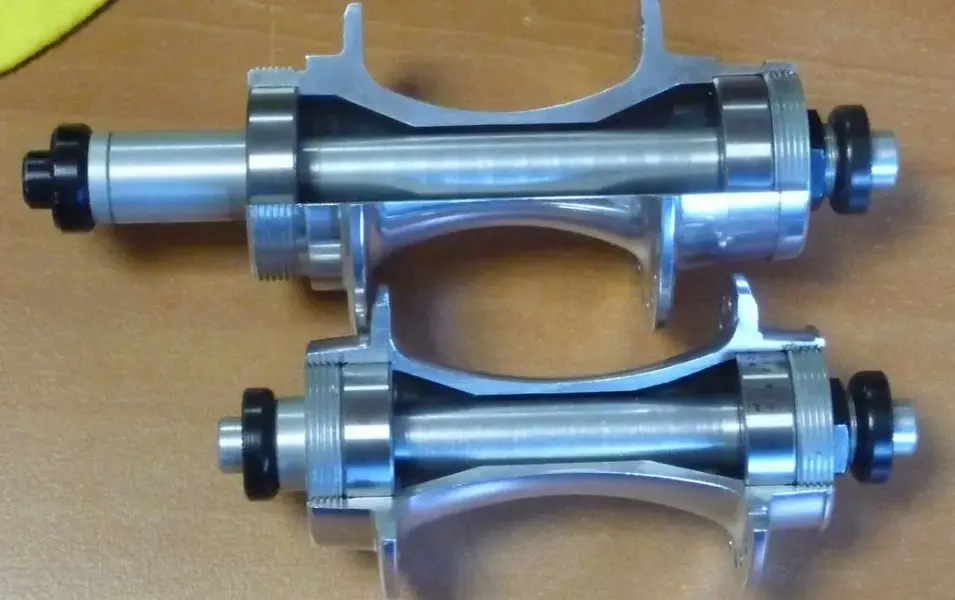

just informing sorry , If you get a choice of 7 speed rear hubs the 550s are stronger than the 500s IMO due the the DS bearing placement. the 550 design concept was then used for every screw on rear hub Mavic made (where the DS bearing is at the extreme outside of the shell)
