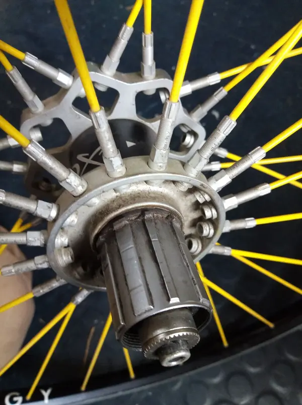

I have a pair of these (Spinergy Spox wheels) on my retro Kona Kula which is being serviced at the moment. The guy servicing them has said that there is a bit of play in the freehub when putting on my new XT 9 speed cassette. Finding it hard to source a new 9 speed freehub for this wheelset. Can anybody help ? Is the freehub specific to these wheels, or is it generic ?

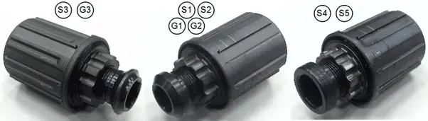

If you do need to replace, the bodies are probably the same as one of the Novatec bodies which are also used by Fulcrum/Bontrager/Crank Bros etc. These have the hollow fixing bolt coming in from the inside of the hub, rather than outside, like Shimano ones.

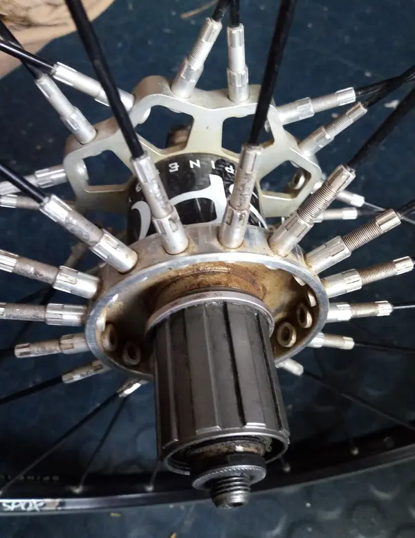

Mk1, carbon shell, steel axle, small flange on the non-drive side, Shimano HG pattern body:

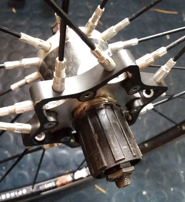

Mk2, carbon (or aluminium) shell, steel axle, large machined flange on the non-drive side, Shimano HG pattern body:

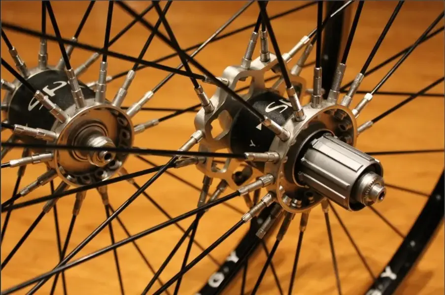

Mk3, Aluminium shell, aluminium axle, large machined flange on non-drive side, proprietary pattern body:

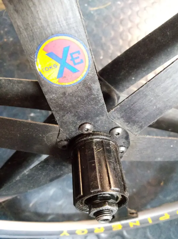

And they reverted back to HG pattern on their later Roks XE: 6-spoke onto machined aluminium hub, steel axle, Shimano HG pattern body:
