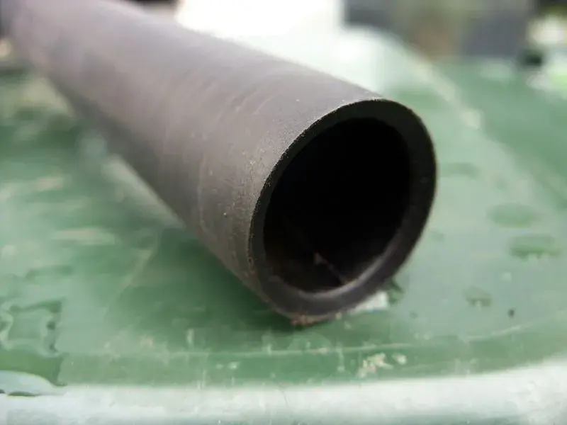

Funnily enough, on Saturday I was given a Peugeot Tourmalet. Think it's from 1986 going by the stamp on the hubs. Anyway, I gave it a bit of a once over and removed the seat-tube so I could adjust the saddle. I was shocked to see that not only was it 24mm, which I had never seen before, but it was also made of PLASTIC!!!

Yes, the post is made of plastic. I suppose it could be fibreglass or something, maybe GRP. It's not a hard plastic, sort of fibrous looking if that makes sense.

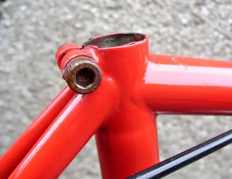

Here you are. Definitely plastic of some sort (or fibreglass) but on closer inspection there is a steel core. It was hard to get a good picture but these should show what I mean.
Interestingly the seat tube is actually narrowed at the top to take the 24mm stem, the rest of the seat tube is probably 26mm ish, I think you can just about make it out in the pic. This is probably different to the frame in the original post which is shimmed although why they would want to is anyones guess. Maybe they had a huge amount to use up and shimming was the cheapest way. Seems a very odd size to go for though.
Ian.

I decided to swap out the budget Simplex drive train for Campag but only had front derailleurs for a braze-on so measured the tube for an adaptor.
I was surprised to find it was a common-or-garden 28.6mm. I had expected something slimmer and having to pad-out the adaptor.
Looking again at the seat tube I can see that it is as GOM described, with the top 40mm being narrowed to suit the 24mm post.
What I thought was a shim inside the tube, is in fact the tube inside the clamp! Just as well I didn't try and get the shim out: what a plonker.
