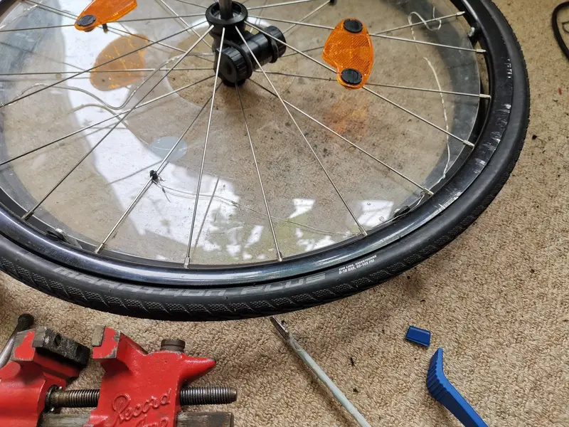

24" fecking wheelchair tyres and punctures.
FluffyChicken
Archivist
How the hell is any normal person suppose to fix a puncture in there.
Not just bending any normal tyre tool (of various types) to get it off.
And then being and snapping your best levers not getting it back in.
You then resort to various long flat bladed screwdrivers, ripping all the paint of the rims.
And then finding your portable vice to clamp the bastard in place to get the fecker on.
Ffooks sake.
So what's the "in the know" nack for these.
Quick easy and simple that any disabled person could do?
For next time.

Marathon tyres are notoriously difficult to get on/off. Repairing punctures on my Brompton would drive me to tears.
The knack is to make sure the beading on both sides is pushed in to the well of the rim as much as possible all of the way around (do not skimp on this step), lever a little more in and repeat. There is no spare tolerance to do it any other way ime.
Ha, I had it sat in as far as it would go, I have experience of bugger tight tyres.
Not much room with the inner tube in there too.
It still stopped way before he shows, you couldn't push this with your fingers, way too thick and rigid.
This was another level of feck.
I feel your pain. I would spend 30 seconds making sure the beading was exactly centred in the well all the way around and still have to use steel tyre levers to get it on.
Now both tubes on the Brompton are loaded to the max with anti-puncture slime.
As you know FC, some combinations are awful. I spent over three hours with a Schwalbe Magic Mary onto a Spank DH rim. Terrible.

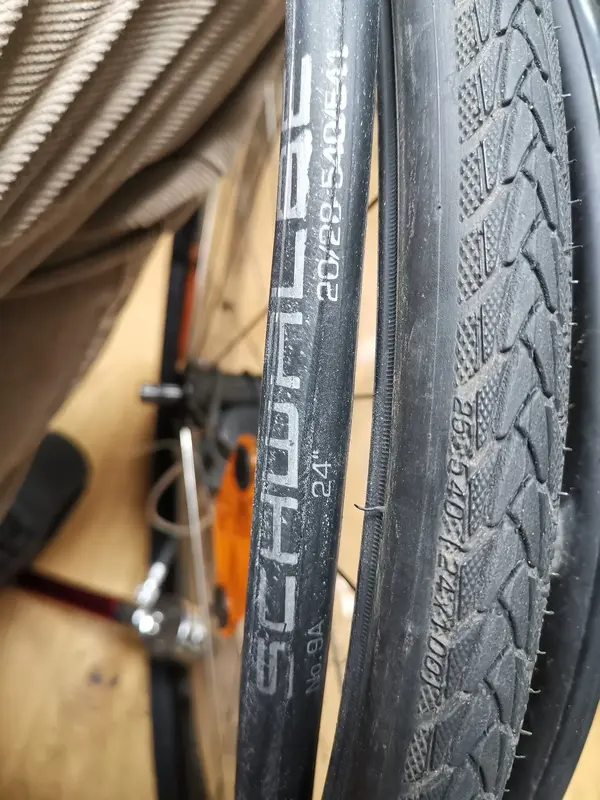

It's a factor of the tight 24" size, narrow 1"tyres, puncture protection etc and it has to be levered on with long metal levers. There is no other DIY way.
The vice was to hold the other side down so it didn't pop out.
He was almost going to get the Islabikes whatever smallnobs or Schwalbe black jack on for a bit. Not the best tyres for a wheelchair.

And to top it off, they (makers) put the tyres on the same direction for each wheel when you look at them. So when they on the chair, one is backwards.
Could have changed it but I wasn't taking both beads of the rim.
Blumming drawing pins!.
I should hope so, they're the ones it came with :LOL:
Edit unless you mean the other tyres, they'll not actually fit as they're mtb 24"
But might have been easier to rebuild the damn wheel itself.
So 25-540 wheelchair and kids mtb 54-507 I think.
