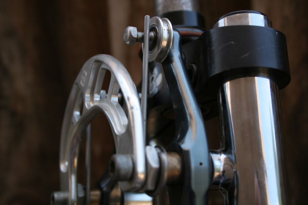

here are a few variations I own not on bikes. there's a few different color combos for the bonded comp(and leg wall thickness) but I've never seen a variation like the one in your pic.
the curvy one has the earlier "chunky" crown
notice the top of the crown above the leg. its the same for the bonded comp, the hole for the leg is just bigger
dealer tool kit
there is a cross crown that isn't slash cut on the top. but it only has 2 bolts
there's 1 missing crown variation for mtn comps in my forks above, and the one in your pic ain't it. and then of course are all the different brazed variations, and the levels of finishing. I got a crap ton more, but you probably get the point
