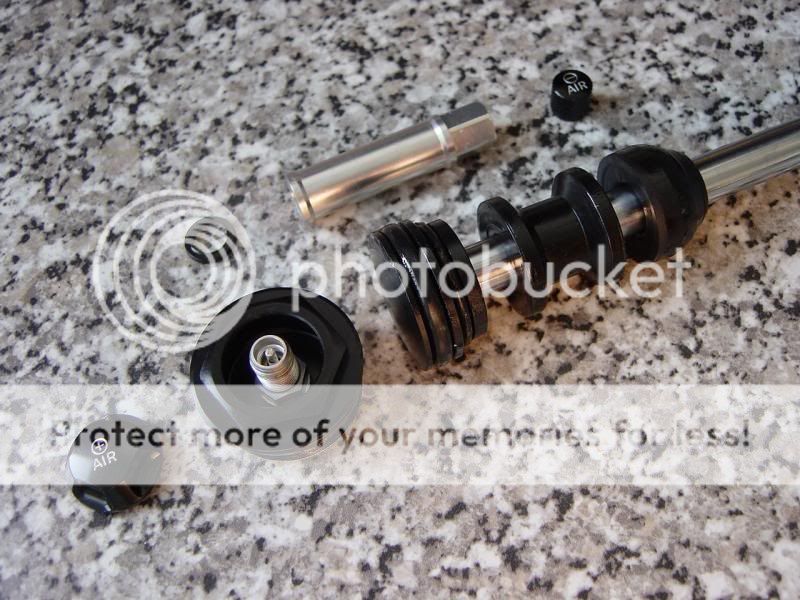

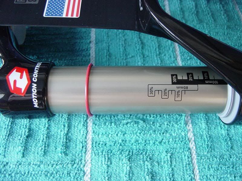

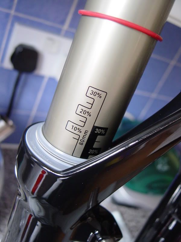

WD Pro":3ruz9zr8 said:
From this :
To this :
By removing the 20mm spacer :
I used these instructions :
http://faqload.com/faqs/bicycle-compone ... vel-spacer
And bought these sockets :
I filed the chamfers off the 24mm socket to give it full engagement with the flat ally head on the forks (to minimise the potential for it to slip) - worked perfect :D
