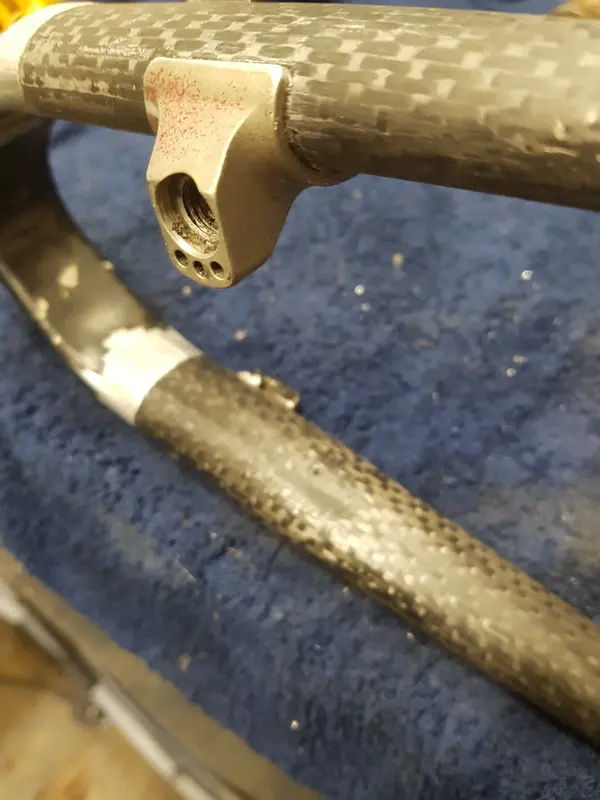

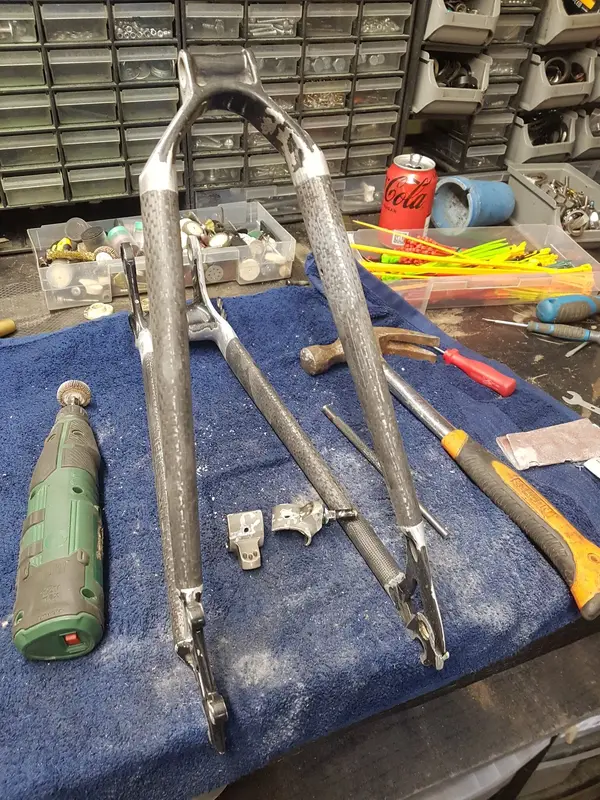

Also I removed the V-brake bosses from the frame. This was a scary job but went smoothly. There was a little bit of 'tear out' when I knocked the bosses off with a hammer and drift but it wont be a problem as I'll be patching the area with more carbon to cover the rivet holes and reinforce.

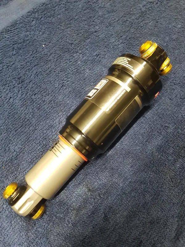

Firstly something fairly easy, fitted my shock mounting hardware. RWC needle roller kit for the top eyelet, standard Rock Shox setup in the lower. I chose the RWC because all the main pivots run on sleeves and bushings so I figured it might improve small bump sensitivity a little.
RWC needle bearing shock mount
I also bought some Ti shock bolts. They came with a threaded centre axle that needed trimming down. (They can be found on Ali express or eBay)
Shock is a brand new Rock Shox Monarch RT3.
