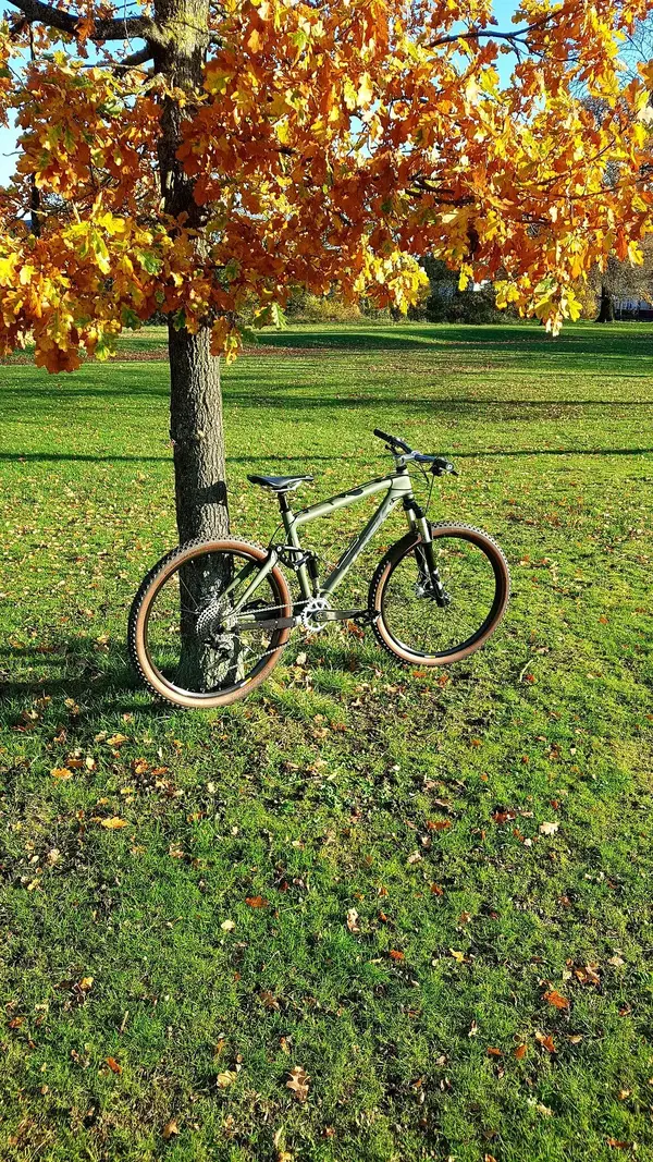

Just checked the weight on a friends scales, bang on 11kg with pedals (24.2lbs) 😎
Spec:
Frame: 2005 Trek Top Fuel 110
Fork: 2012 Rock Shox SID, XX Internals, upgraded comp damper
Shock: 2016 Rock Shox Monarch RT3
Headset: Works Components 1 degree angle set
Seat clamp: Bike Yoke Squeezy
Brakes: Shimano XTR M985, M9000 carbon lever blades, Superstar Race Matrix pads
Disk rotors: Formula 2-peice (180mm front, 160mm rear)
R/Shifter: Shimano XT M8000 11 speed iSpec
R/Mech: Shimano XT M8000, Garbaruk lower jockey wheel, Ti bolts
Cassette: S-ROAD 11 speed (AliExpress)
Cranks: Sram XO1 carbon
Chainring: Garbaruk 32t
Chain: PYC SP1101
Bars: Raceface Next carbon 31.8mm x 725mm
Stem: Tune Geiles Teil 4.0 75mm
Pedals: Crank Brothers Stamp 7
Grips: ODI Elite Pro
Seatpost: One Up Components 120mm
Seat: Fabric Scoop Race (Ti rails)
Wheels: Mavic Crossride FTS-X, set up tubeless with Muc Off tape and valves
Tyres: Continental Cross King 26" x 2.25 'Bernstein Edition'
Misc:
Rear brake adaptor: Formula
Front brake adaptor: Intened Blackline +20/23mm
Dropper post lever: Bike Yoke Triggy Alpha (iSpec)
Shock hardware: RWC needle roller kit, Ti bolts
Mech Hangar and Bolt: Race Ti.

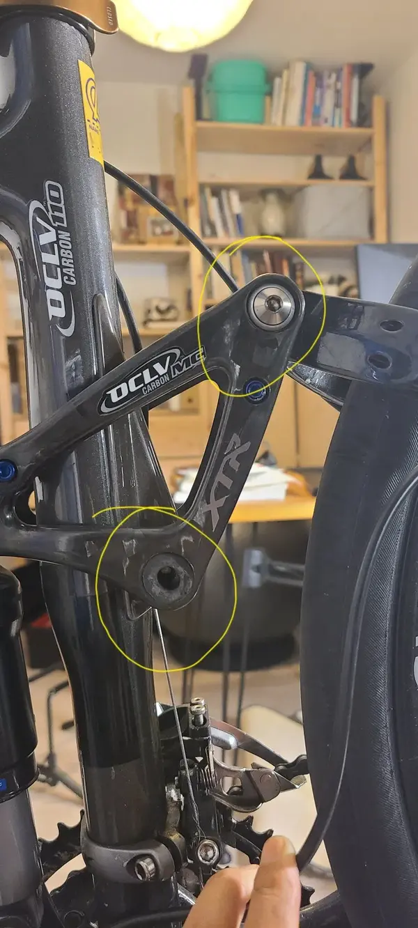

Any chance you can put me in touch with Sue Skeggs? My pivot bolts and whatnot fell out and I have no idea where they are! 😅
Hi mate.
[email protected]
Looks like the bolt hole on your rocker link is ovalized. Mine was the same so I replaced it with the alloy version: eBay link
If you ask Sue she may be able to get you a replacement carbon rocker link plate. Part number 221502M
Part numbers and diagram on page one of this thread.
Good luck 👍
