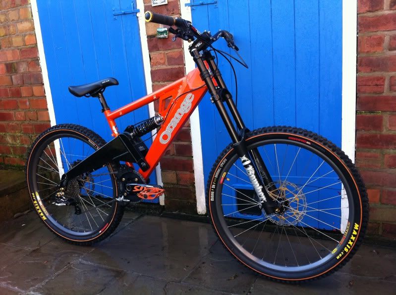

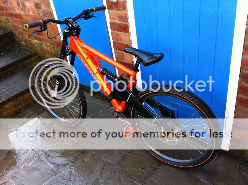

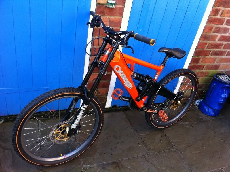

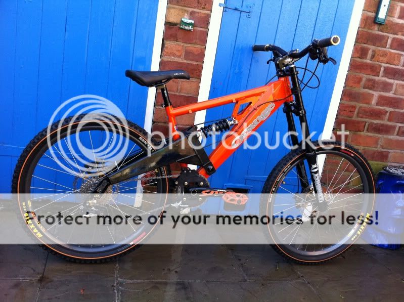

Few more updated pics & updated spec list as this seems to be a bit of an ongoing project.....
Frame: 16" Orange Patriot 150mm travel
Shock: Fox Vanilla with uprated spring (800 x2.39)
Fork: 2004 Marzocchi Junior T 170mm travel
Headset: FSA Pig Pro 1-1/8" threadless, cartridge ball bearings
Handlebar: 2011 Azonic Double Wall 765mm wide
Stem: RaceFace Diabolus 70mm
Rear Mech: Shimano Saint, 9sp, short cage
Shifter: Shimano, 9sp rapid fire trigger
Chainset: Shimano Saint M810 cranks, 40T Goldtec chain ring and Superstar Laser Chainguide (saint cranks have custom protective graphics fitted)
Bottom Bracket: Shimano Saint M810 BB
Pedals: orange DMR V8
Cassette: Shimano HG50, 9-speed, 11-34t
Chain: Shimano HG50, 9-speed, Sram powerlink
Front Brake: Shimano Saint M810 4 pot caliper, Gold hope 203mm saw floating rotor
Rear Brake: Shimano Saint M810 4 pot caliper, Gold hope 203mm saw floating rotor
Rims: Mavic D321, Grey 32h
Front Hub: Hope bulb, QR, 32h
Rear Hub: Hobe bulb, QR, 32h
Tyres: Maxxis Minion DHF & DHR 26 x 2.35 with orange pin strip
Seatpost: Alloy, micro adjust, 27.2mm
Saddle: SDG Bel Air
Grips: B1 Racing with gold lock-ons
How do the new forks work mate? They seem to slacken the head angle a bit as seem longer than the old drop offs?
Looks neat mate.
The frame was designed for 150mm forks, so the 170mm is slightly out....
I was told that plenty had ran 170/180mm forks and never had issues though, and as it was out of warranty it didnt matter for that.
The bike handles really well, its only used for DH/Freeride anyway so a slack head angle is ideal!
Yeah didnt think it was a bad thing, just you can see it will handle differently.
