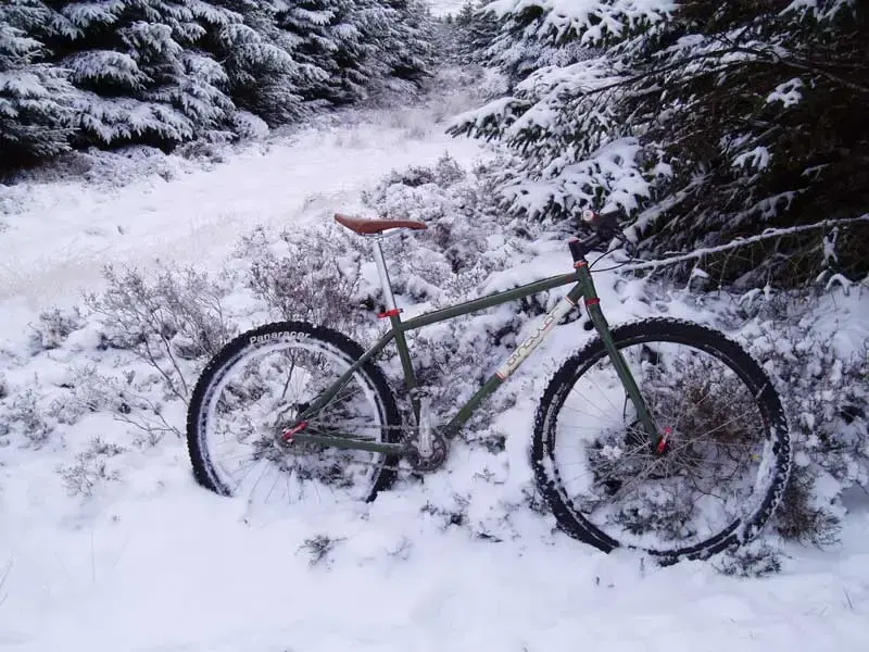

yostumpy":1aytnn3v said:
How is your bike proportioned then? :D
Hmm - 17" seat tube, 23.3" ETT, in-line seatpost, either 70 or 90mm stem (depending on how I feel, I suppose) and Easton Monkeylite low-rise bars.
EBB set pretty much as far back as possible to shorten effective chainstay length and give as long a front centre as possible.
But then, I spend most of my time out of the saddle and I like a bike that's long enough to feel right for that and still use a shortish stem.
Bar height is about 1" lower than saddle height, but then I run the saddle slightly lower on a singlespeed than I would on the same bike with gears.

yostumpy":1gy0wb6k said:
I tried a search for your bikes in readers rides but Soooooooooo many pages! got any piccies!
Well, just because you asked :wink: - here's one from about two hours ago, on my last ride of 2010 and another from about two weeks ago, in the snow. 8)

yostumpy":d0ljruo2 said:
Nice, is that the singular 29er! Your spoon looks quite forwardish in the post.
It's the Hummingbird , the rear wheel's 26". It's a 69er and a real pleasure to ride 8)
The saddle rails are just about in the centre of the adjustment range - I find it easier to spin high cadences if I'm not too far back, hence the in-line post. For the same reason I run my saddle about 10mm lower than I would if I had gears, again, I find it easier to spin at around 120rpm. It's never about seated power on a singlespeed mtb, any time that you need power you're out of the saddle.
