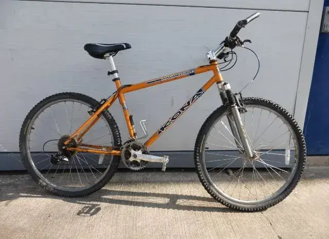

Hi everyone,
I’ve recently picked up a 2001 Lava Dome with RST381 forks. They’re in pretty poor condition and not sure they’re worth salvaging, so on the market for a replacement.
I’d like to fit a rigid fork, and have been on the hunt for a set of Kona P2 with no luck so far, so have been looking at the carbon.cc and Rose alternatives. My preference would be carbon over alu/steel although tat £40 the Rose ones have some appeal! Forks need to be 26” threadless and V-brand or canti compatible - not disc. Are there alternatives I should be looking at?
But what length should I be looking for? The RSTs are approx 80mm travel but not sure they’re original (RS Jet according to catalogue)
Thanks in advance
Nick
I have the Exotic 420mm forks on my Kona Kaboom, which has identical geometry. They take out buzz a little more than the P2 (I had a triple butted set on the bike) and can thoroughly recommend them. They are no lighter than the TB P2 though!
Typically they’re the ones sold out on carbon.cc so will have to find them elsewhere. Have you tried the alu ones? I imagine they’d be a bit harsh.
The Rose ones also look like they might be a bit short at 39.5cm
39.5 is definitely too short, the bike will be nervous and twitchy.
I've not tried the alloy ones. However, looking on the site the carbon CC-F0225 combi IS disc and V is in stock.
Unfortunately that’s the 1 1/8 steerer. 1” sold out and not back in stock until nearer end of the year. I’ll keep an eye on classifieds and eBay until then
