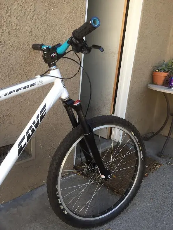

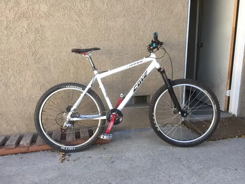

Bike is built and ready. Though I think I will need a short cage derailuer

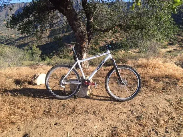

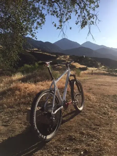

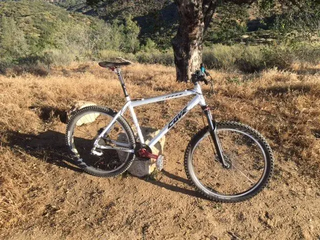

Took her out for a 14 mile ride today. Man what a difference over my Chameleon. This bike climbs like a goat and handles DH amazingly. Really love this ride.
