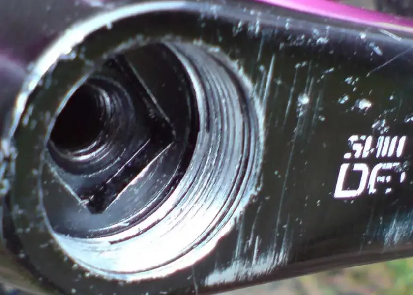

If your cranks are completely screwed then you may as well just cut them off and save the expense. Just saw a slot or maybe two in the crank where it joins the bb axle and tap off with a hammer and punch. Or are you concerned you might damage something else?
I'm hoping the cranks are okay. I have a lot of movement in the bottom bracket - which I want to get out to see if it just needs a regrease or new bearings - or replacing. The posts above are advising to service rather than replace.

I thought you said the threads stripped out of the crank when you used the crank puller? I was assuming they were FUBAR.
Cutting the cranks off won't ruin your BB, just make sure that you hacksaw through the soft aluminium of the crank shoulder, prise apart with a screwdriver and tap off with a hammer. Nowt intellectual there. :wink: I didn't mean hacksaw through the bb axle! :lol:
If you reckon you can use the cranks again then apart from the puller I can't think of another non destructive method. Even using heat would probably remove some paint unless you had it well shielded - difficult?
Yes - I was hoping to keep using the cranks. The thread is only there for removal right? So I thought I'd buy the cheap gear puller and try that. If no joy then I guessI'll resort to the sawing!
Have a look....
The thread is there for the crank bolt to keep the cranks fixed to the bb as well. Although it seems yours doesn't need it. :roll:
I've seen it suggested before that if you ride around on it without the crank bolt in it may work the crank loose.
