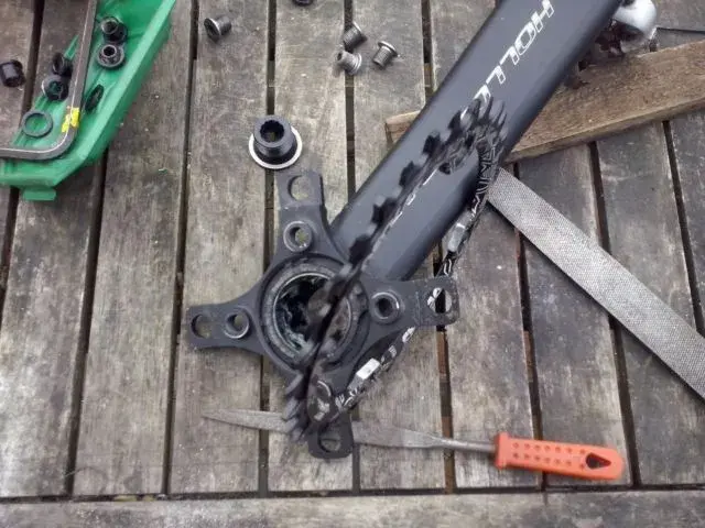

... waiting for pay day until i can buy the direct mount chainring, meanwhile i modified 32t ring to fit on inside of the spider. Filed about 1mm off the 4 lugs, the shiny metal in photo, which should put the ring further in. The machining on the lugs is asymmetrical so probably not what cannondale had in mind.
