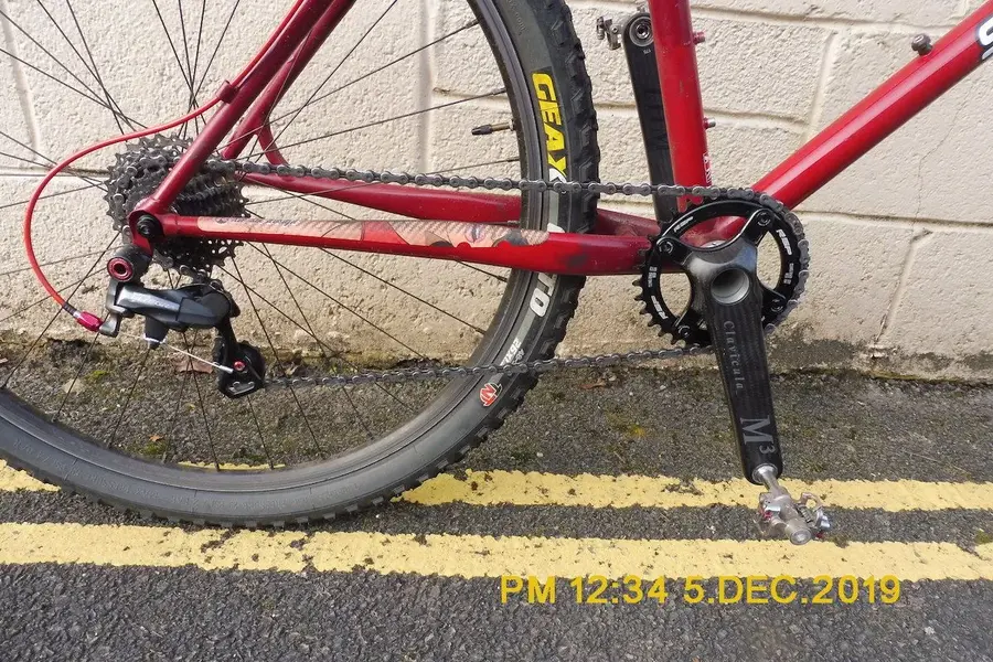

1x10
One thing about the change over is that it doesn't look right with one 32 up front to my eyes. So use't to seeing a 42/32. But changing gear is now much quicker up and down the cassette with out thinking about the 42. I'm happy to have changed. Never thought i would. How does a 'narrow wide tooth' design chain ring reduce chain fall??

still looks odd. But great riding. Next the Trimble
