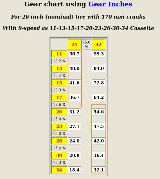

Ideally, you could run a 2x9 to keep all but the fastest cog
24-42 up front, 11-34 9 sp casette (see below)
The thing is - can the front mech handle an 18 tooth gap between gears?

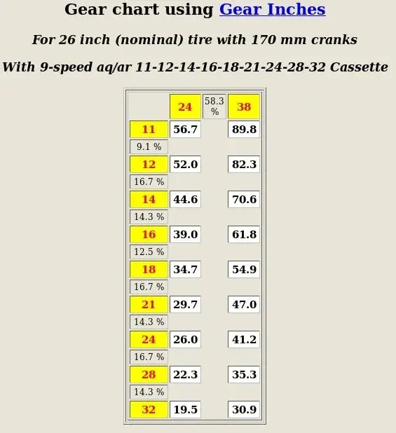

might try running a 2x9 on the XCR
24-38 front and 11-32 rear
the terrains pretty hilly...
mechs should be able to handle a 14 tooth gap..

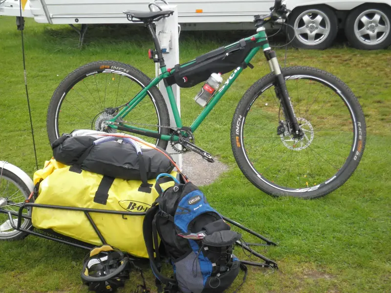

Ive just done a week in Scotland towing a BOB trailer with mine and it was great.
