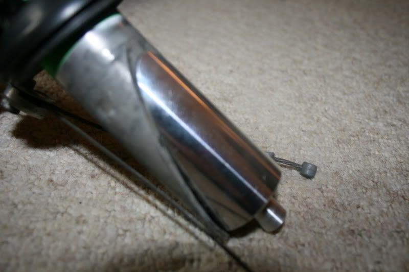

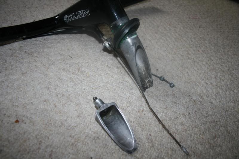

Now stripping the bike to get ready to send to Jonrock for paint, and after discovering the stem bolt had snapped on the thread, i reckon due to the previous owner overtighting.
I have tried to source a new quill and bolt but to no luck, one company quoting me 4 pound per bolt but i had to order a hundred of them :(
The beutiful thing about owning a CNC machine shop was to get my employees to make one!! :lol: :lol:

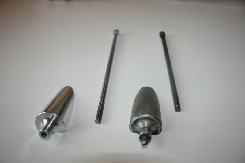

So quill made, as the bolt snapped inside and I tired everything to remove it, and also under inspection the quill had a split in it.
So onto a CNC lathe followed by fixturing onto the CNC mill. Job done, now need to make the stem bolt, which will be on the machines this week.
Picture of the old quill:
New quill in place:
Old & new quill:

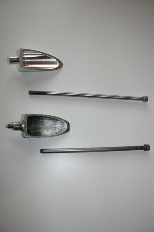

Next the Quill bolt is complete! Pictures along side with the original quill and bolt with the ones I made.

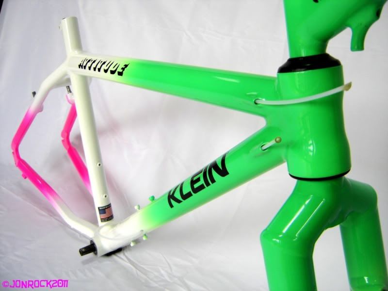

The biggest update is complete!!! In about 2 hours time my driver will be getting back with a freshly painted frame, and judging by the pics It looks blooming amazing!.. The klein paint master has done his magic!! thanks Jon,
Omg, i cant wait, this week & weekend will be building, I am sure I have all the components to get it running, but will need the use of a few modern parts unitl I can replace them with Retro ones.
Heres the pics from Jon's website:
