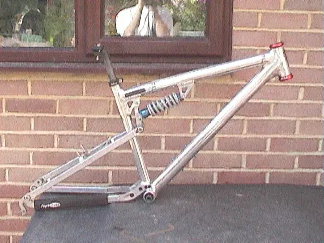

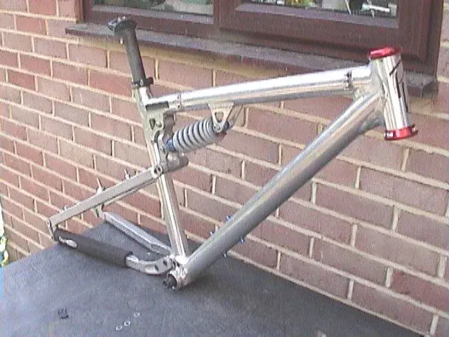

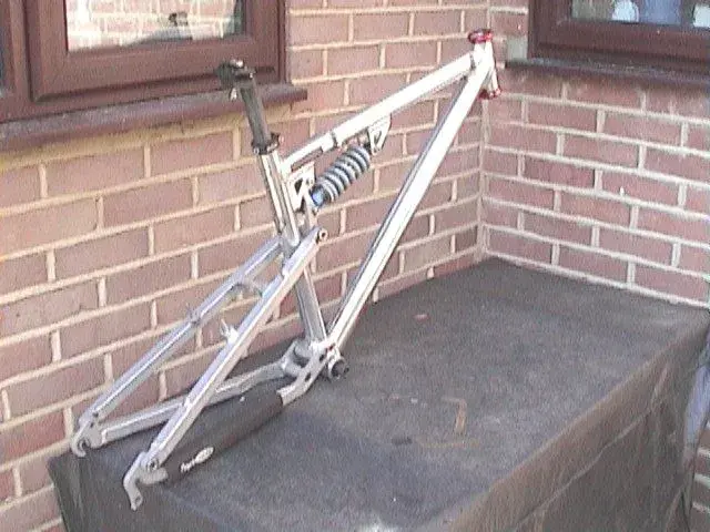

cant seem to find the good pics but found a few low res ones of when i first got it as a frame and one built up, sorry for the poor quality!

Wow, thanks for all the great info, Matt! So maybe the old 650x196 spring would be just right at 4.5. But it's so dirty/ugly, I would rather replace with a newer one just for visual, and if the length is 1.5 I could easily swap springs which would be nice.
I assume the bottom hole for the back of the shock is for 4.5 and the higher one (like you're in in your second pic) is for 3.5?
