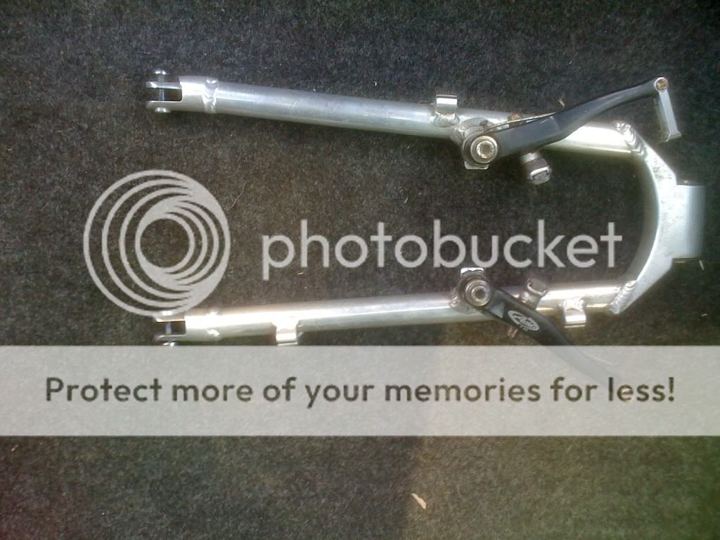

After getting it home and stripping it down I discovered it had a crack on one of the rear linkages.
Upon furthur expection of the whole frame I found a hairline crack on the headtube/downtube weld.
For these reasons I can only sell the frame in a sold as seen state, I can't speak of the health of the rear shock as I never got the chance to extensively use it. The frame has seen plenty of use over the years and has plenty of marks to prove it.

Hmm, I think the headtube weld would be an easy fix as it's just a hairline crack and you could put a good strong weld there.
The other crack is trickier as there's not much material to go on.
I bought an old Kona Dawg frame to try and use parts of the linkage from it but unfortunaley they were different sizes and wouldn't marry.
So the headtube, yes, easy fix.
The swing arm crack, tricky!

Mine snapped in exactly the same place..
I took it to Hollinwood Welding in Oldham who repaired it for £20
Sorted :D :D :D
Heres a few pics of my snappage
http://www.retrobike.co.uk/forum/viewto ... highlight=
So YES it can easily be repaired
