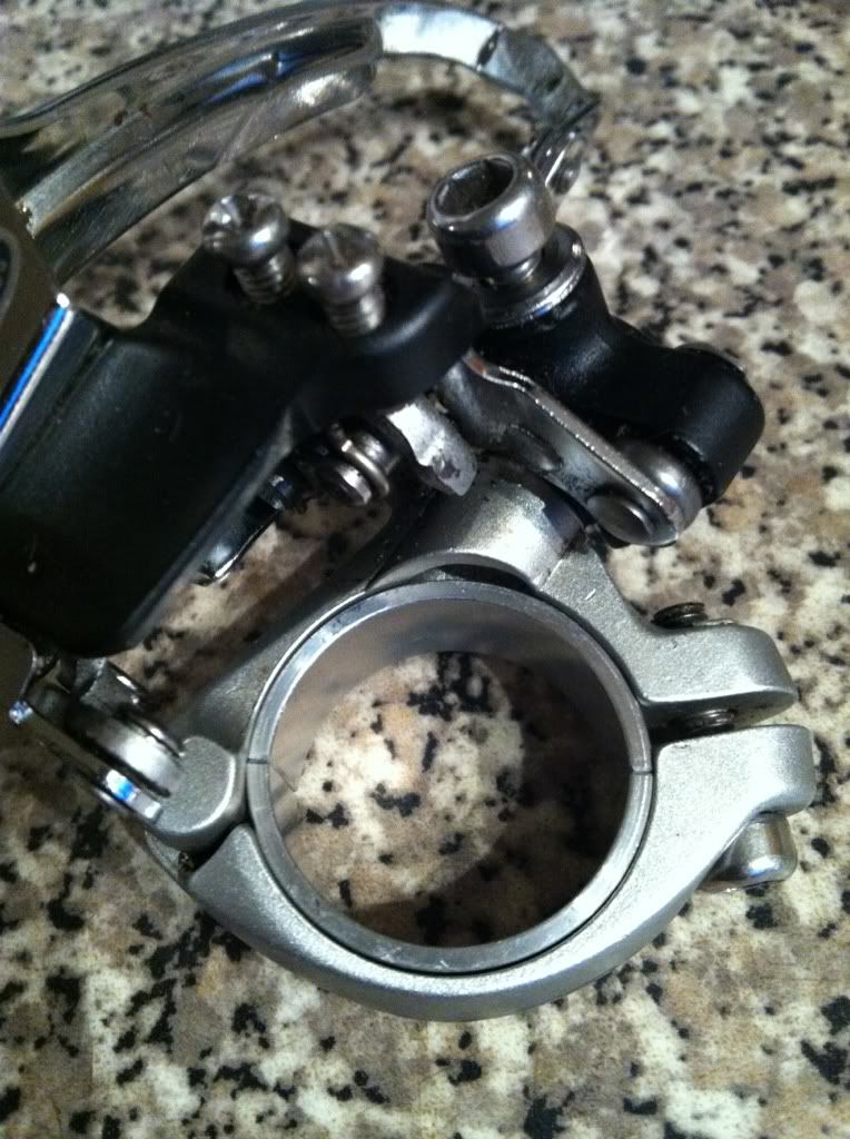

XTR 950 FD in 31,8

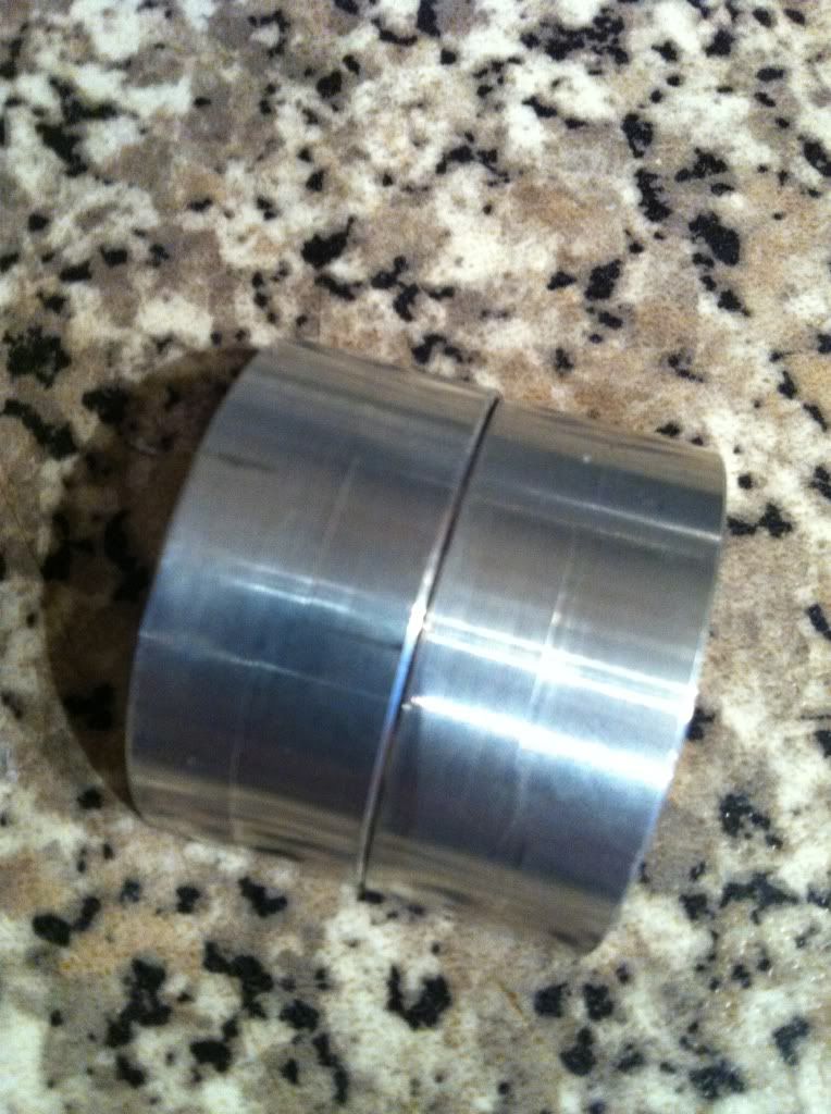

can I use any of the available Shimano shims from 31,8 to 28,6 mm, or,...?
total weight till now 8177 gr
Most shims are 34.9 to 31.8 or 34.9 to 28.6, think you will struggle to find one that is 31.8 to 28.6, although I think there was an XTR m960 shim of that size.
Also, in case you didn't already know XTR m950 is designed for 8 speed.

I was in the same boat with my cindercone build a few weeks back, couldn't get a 28.6 tp m750 mech so I made a shim to fit my 31.8 version.
I've since found the correct size mech, so this shim is spare?

yes, I know that the 950 series had been designed for 8 speed use, but the cage is wide enough to be capeable of 9 speed usage, too.
magas":iiazigiq said:
good idea with the roadie mechs, will check out :)
I've run 8 speed FMs on 9 speed but IIRC 9 speed FMs are a touch wider??
