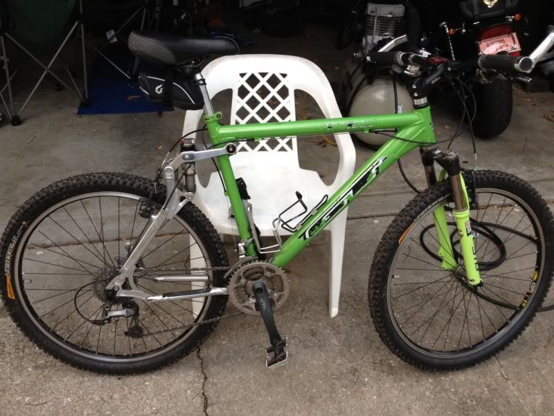

GT took several measures to achieve a lighter frame compared to the "old" LTS, resp. the LTS-DH of 98:
- Multiple butted EASTON 6061 front triangle, taken from the Zaskar LE. Therefore, a German magazine used the title "Zaskar with LTS-Suspension" in their article.
- Usage of air shox at the rear: the Fox Vanilla R is considerable lighter than the Rockshox Deluxe with spring
- Linkage was milled out to save approx. 40g.
- allegedly, GT also used the plastic bushings because they were lighter than the needle bearings
My 18" frame weighs 2795g incl. rear damper and including the metal bearings/bushings upgrade (which are quite heavy). For comparison: a 95-97 LTS 1/Team with Rock Shox damper and plastic bearings are around 3050g.
As it was sold as a complete bike, GT also used light parts, including first Generation Crossmax and first Generation of SID forks. The SIDs were painted black instead of the blue. The rest of the Setup was XTR 950/952. Not sure about the other parts.
Pre-production models were anodized green; the official production ones were all ball-burnished.
(C) FC_Bryan / mtbr.com (who claims that he bought it from a former team rider)
Production numbers are unclear. Some claim that only 50 pieces were made. I think, at least 100 were made, maybe even 200. I have found the serial numbers 99, 150 and 190 (mine). All these frames were built in february 1998:
When looking for Information of this model, some declare the XR-1000 as a 1999 model. I think, it is a 1998. The frames were built in february 1998, delivery started in summer 1998 (model year 1999 did not start until autumn), the decals are 1998-style ("arrows") and the 1999 catalogue, which was published in autum 1998 did not contain this model.
Ultimately, I think this is not only the lightest, but also best LTS GT every made!
