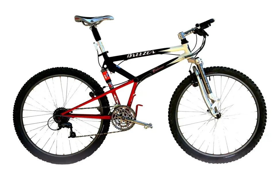

The Sweet Spot bikes always had a pretty nice look to them. Haven't seen too many of the Breezer versions. These originally had pretty mid-level components but since we got this one as a frame, we built it up with nicer parts.

Here's a 16.5" Breezer Twister which I recently completed the build on. It includes an Interloc TL5 fork, also the design of John Castellano, which was OE on the '98 Breezer Tornado and is a fine compliment to the Sweet Spot rear suspension. The method by which additional standover clearance was achieved for the 16.5" Twister made for a pretty interesting looking frame.

Nice work with your Twister.
We sold our Twisters the first year, 1997, as bikes with LX-ish parts, and also as bare frames. In 1998, we added the Tornado SweetSpot bike, which had XTR-ish parts.
BTW, you've got the Alps5 shock in my originally intended configuration. At the last minute, Fox modified the design and it needed to be flipped end for end. Perhaps this frame has had some "custom" modifying? Looks like it works...

Nice bike Joe
I see you like the newer hite-rites ;)
I've always fancied riding a bike with that styleof rear sus, just to see what it's like. and as for the linkage forks - they just make sense to me.
I really wish I could persuade Rory at USE to make a SUB with modern internals :(
I've just spotted the clever bit on those forks - it looks like the top linkage acts as an anti-dive linkage!

How odd - my two favourite forks,one leading link,one trailinglink, both have anti-dive features!
Yes, the IRD fork does have anti-dive.
