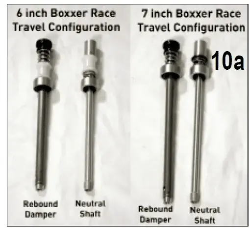

OK, I've got a 1998/1999 boxxer 151 that's apparently been converted by betd to 7" from its original 6" setting. I've then got a believed to be 2003 boxxer race (has brake boss holes but no hole drilled In the fork brace) which is also a 7" fork. My question is does anyone reckon these can be converted by swapping the positions of internal spacers? Or are they destined to be 7" for life? If parts are required I guess they won't exist anymore.

The 03 service guide shows the two white plastic spacers that usually sit on top of the coil springs (on 7" forks) repositioned to the damper and neutral shaft. Dunno if I'm confident enough to have a dabble and taking them down to 6" just based on this though!

Oh, and just to clarify, I want to take them down from 7" to 6" as my 98ish lobo and DHO bikes would have had the 151 in its 6" original format.
