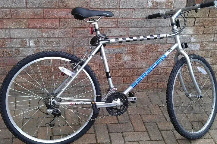

Also been doing up a Saracen Hardtrax (approx 97) - but not quite as thoroughly as you!
Got my bro to do new graphics, with the new font - since the old decals were pretty wrecked.
Basically got new seat, pedals, chain (KMC), sprockets (shimano), rear wheel, tyres, handlebar grips. Aimed to keep the look pretty similar.
Since the pic was taken I've added a Shimano Alivio rear derailleur, lezyne bottle cage (+kcmc bolts), and am planning a new front derailleur and middleburn chainrings (and raceface chainring bolts). Going for the Middleburn cos they seem to be the only 5-bolt rings with the right number of teeth (42,34,24).
Can't shift onto the 3rd chainring at the mo, so hopefully can sort that out with the new derailleur. :P
All the best w/your project. :D
PS: Planning a black bikehut handlebar too, cos it's lighter and looks cool.

That's a '97 alright!
I think those are the new graphics you've got there - which will confuse the hell out of people! :wink:
When I had mine first time round, the seat, grips pedals & bars were the first things I changed!
Yeah, Middleburn still seem to do the very nice 5-bolt stuff, which is good!
If you've still got the original Chainset though, which it looks like, you'll have to change the entire thing, because the Altus OEM chainset doesn't have removable chainrings!
Front Mech is a SRAM Gen-X, the first of the X-gen mechs, but still compatible with the 28.6 seat tube! Otherwise I'd recommend a 90's Shimano XT as they just never quit!
Cheers Osella!
Yeh - the new graphics on the original frame are a bit of a cheat lol, but I guess it's still pretty recogniseable cos've the shape of the frame compared to modern ones? :P
Yeh, just realised I'd have to replace the whole chainset, when I saw the current one has no bolts, lol. Need to do so anyway really, since the some of the teeth are in a pretty bad state (the lad I got it from - for £20 - hadn't changed the original chain at all).
Thanks for the advice re: front mechs! Will have a look into it! Was originally thinking of going for this:
http://www.gooutdoors.co.uk/shimano-fro ... it-p200505
...since it fits 6/7 speeds and the current number of teeth on the chain rings (I'll keep to the same number with Middleburn ones).
Had a bit of trouble with the rear sprockets - cos I got an 8-speed rear wheel with spacer, it pushes the gears to the right so pretty hard to get into 7th lol. Oh well.
@azaro. Yeh - the original graphics were great... but completely wrecked on mine. Was just easier to copy the newer font - plus fancied a bit of a change. :P
