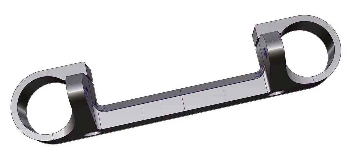

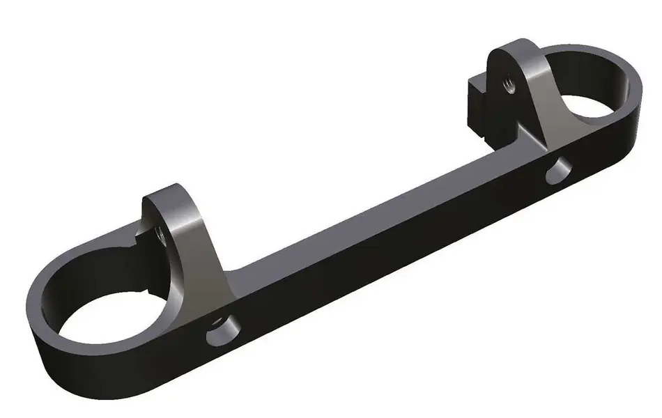

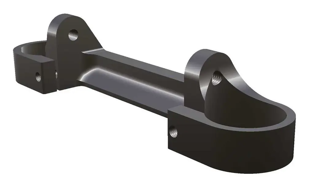

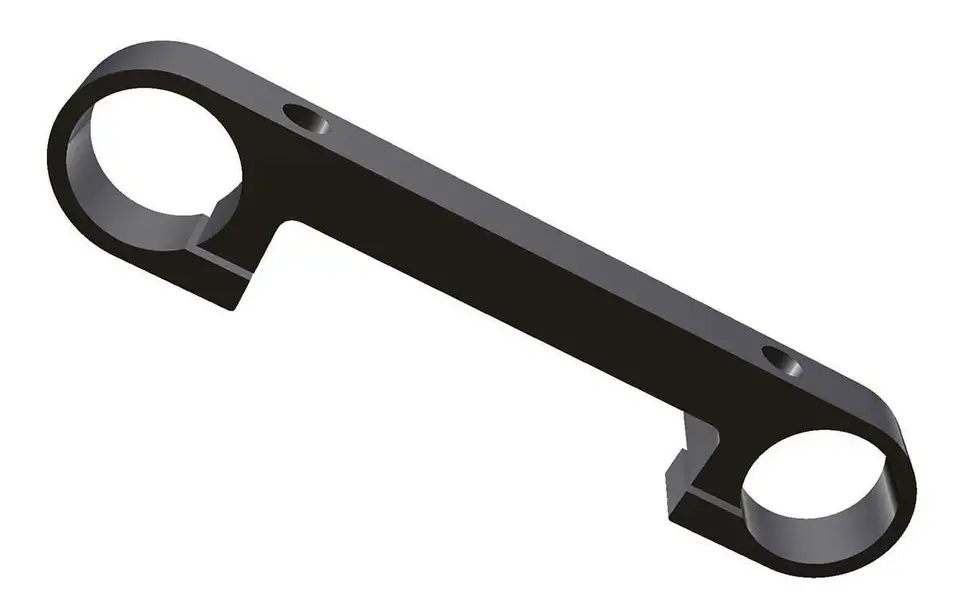

Got the CAD done for the fork braces. Off to the rapid-prototyper for proof of concept. Don't want to mill the wrong parts in aluminum.
To gis-guru: what's the thickness of the braces from the front view? I worked to your measurements but I didn't have any measurements from the front view so I emulated the thickness by looking at pics and comparing to parts I have. It's 15mm thick as of now. Also what's the size of the pinch bolts? I'm using M5 because M6 would be too big (internal clearance issues). I also added a stiffening lip on the lower back edge (now the brace has more of an L profile thru the middle). It seemed a little wimpy in the original version and I hope the additional material won't interfere with the linkages, and add some needed torsional stiffness.

Now that looks great. I haven't had a chance to look into bearings yet but the info you provided is a massive help. How do the bolts attach with the pin you mention? I'm assuming if I can get the right bolts I can cut the groove out?
The bike is at a local shop on display I will stop by and make a few more measurements and get back to you today or tomorrow. I believe the bolts were M5 but they may actually have been smaller, but I know that they weren't M6's
Chris
By the way that is some nice CAD work.
"The bike is at a local shop on display I will stop by and make a few more measurements and get back to you today or tomorrow. I believe the bolts were M5 but they may actually have been smaller, but I know that they weren't M6's"
Thanks Chris! I think M5 is the most likely measurement, they fit in there and you need to give them a decent amount of torque to have them stay put. Smaller screws might be too wimpy.
Could you look if the ridge I built on the lower edge through the middle would interfere with any linkages or the head-tube? It sticks out about 6mm compared to the top part of the brace, has a flat of 2mm and from there it goes up at a 45 degree angle with a big fillet along the connecting edge. I don't have the bike put together so I can only speculate about the clearance. From the pics it looks like there might be some space but I'd like to double check.
Raul
Will check out the clearance and let you know. I do like the idea behind it and hope that reality doesn't interfere with the design.
What are you going to do with the lower headset cup, the one I got from the guy with all of the Nukes on ebay didn't have the stop built into the back of the cup lip. I assume yours was the same?
Cheers
"What are you going to do with the lower headset cup, the one I got from the guy with all of the Nukes on ebay didn't have the stop built into the back of the cup lip. I assume yours was the same?"
I got lucky and I got two cups, one with, one one without the stop. Obviously I'll use the one with the stop, means I'll have to drill the positioning pin into the frame...
The built in stop is a neat feature, but there are plenty of linkage forks out there without it, so you could always use double crown fork rubber bumpers instead (slide them on the fork legs between the braces.)
By the way, could you also measure the size of the cockroach badge? I'll have to start on re-creating the badge as well and I'd like it to be the correct size. If you have a camera with you, could you snap some close-up pics of the badge and the clearance area between the fork bridge and the frame and linkages?
Thanks again for your help!
