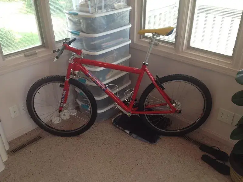

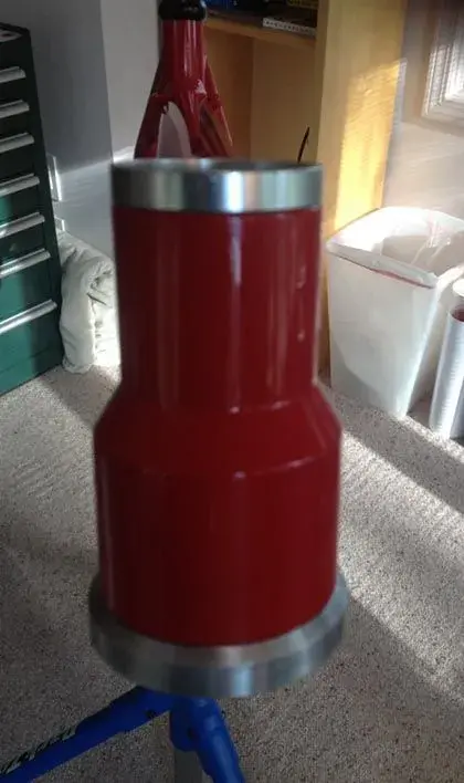

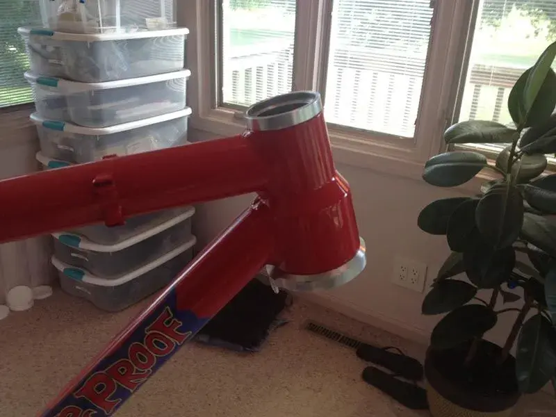

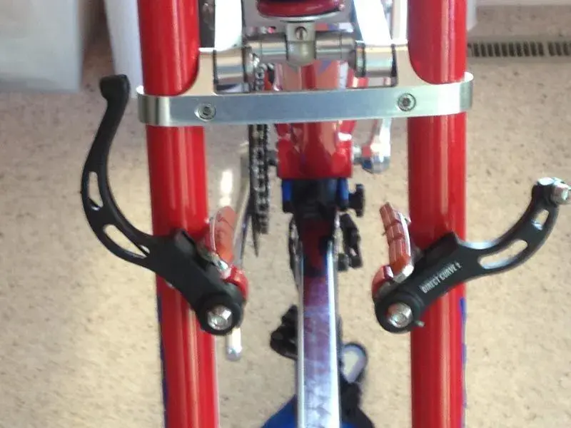

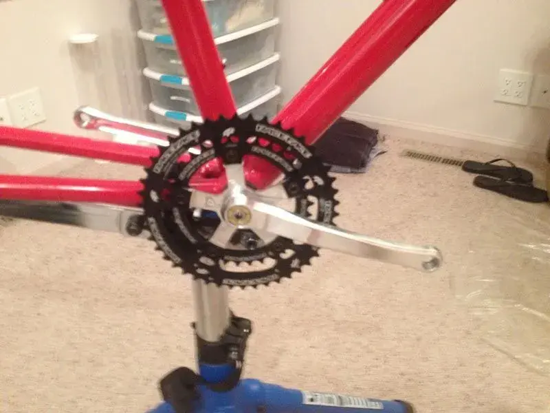

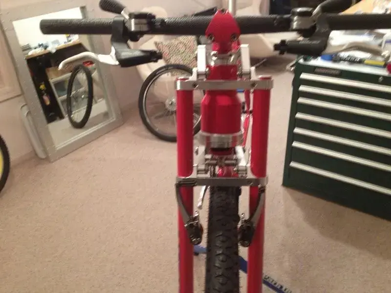

The shock finally arrived! Barely any of the original pieces left and it looks brand new. Attaching some of the build photos. The XTR v's I had intended for the build fit too closely to the front fork and hit the fork legs when tightened down. Luckily I have a bunch of alternate brake choices; Cane Creek Direct Curve, Tektro 872, IRD Camfam and some Pedersen SE's. The Cane Creeks work but have almost no stopping power. They look OK but they are quite what I wanted. At this point I am thinking Pedersen or IRD. The build came together OK but the fork assembly was a pain and I now understand why they didn't make them for more than a year or so. I polished the fork pieces within an inch of their lives and took off all sharp edges but still managed to gouge the powdercoat. It should polish out OK but still makes me mad. The powder was so think it took awhile to get the bolts to thread into the upper and lower structure and the fork top actually shows about an 1/8 of an inch instead of being flush as it was too wide at the top hen flush.

Yea, updates!
Looking good. Bars/shifters are a perfect choice.
This bike is one of the few that I would use V-brakes on, though I don't have any suggestions as to what would be best.
I've said it before and i'll say it again, I really like this bike!
I've always had a soft spot for all things Nuke Proof, and this looks amazing...
...but what a totally OTT front end for a hardtail! 8)
