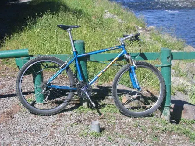

My favourite 97 Kilauea is the extremely rare Kilauea SE, with Z2 fork and frame colour-matched to it, as below.
