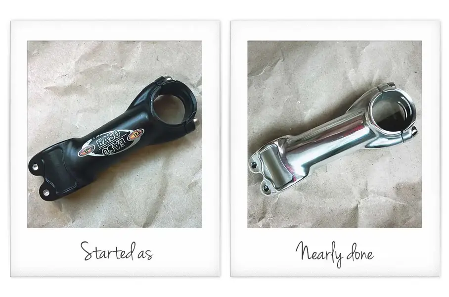

I bought this stem, 100mm & 8 degree, which arrived today. Bit of a rise helps a dodgy neck. Again the colour was wrong but was easier to polish than the bottle cage. I used oven cleaner to remove the anodising then wet and dry and elbow grease. I could have bought a Ritchey Classic stem and saved me some work but I'm not overly keen on the looks.
