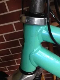

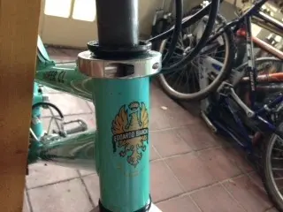

Re: Bianchi Super GL Neck Repair
Well I just got my Bianchi Super GL back after having a machine shop taper the neck reinforcing collar I had made to remedy the crack at the top of the neck. The collar is flush, tight, and appears to be a very reasonable solution to this issue. It closed the crack, and restored the tollerances with only a few ounces of weight. I also got rid of that adjustable stem for a Felt alloy stem, and am awaiting new light weight bars to install. The Omni fork has also been canned for a correct Rock Shox Judy.
Should have it out for a test run sometime this week.

willbowden":t54qw5qn said:
I can't decide if thats a beautiful bike or the ruins of a collapsed factory, theres certainly lots of metalwork going in all directions!
I'll go with beautiful bike though as its a Bianchi and I won't have a bad word said about anything painted Celeste ;)
Will :)

Hey, Matt. The repair looks pretty hard core. And it will keep the crack from growing?? Interesting enough, I know that bike was only made in two sizes. 17" and 20". It looks like you have 17 and I know mine is a 20", but by the way it's designed the stand over clearance is more than my 13" kona hard tail. It's kinda like the bike is one frame piece away from being a full sus. woman's comfort bike. Compared to you and your son, me just a runt at 5-7, 145lbs, tho I do 3x a week at a cross fit style gym. It's helped my cycling tremendously, tho at 61 I still get my a$$ handed to me on the trails, haha. Like Mike mentioned in his post, don't think of a lot of Bianchi MTB's. Only one that always come to mind is the grizzly. I know zilch about their road bikes. Again, nice job on the collar repair and hope it holds up,as it looks like it will.

Hello Steve, it is seriously strong. The engineer that machined the piece does, or did, parts for NASA. He did some pressure test with an expansion device, and assured me that the neck, at the top, was substantially stronger than original.
