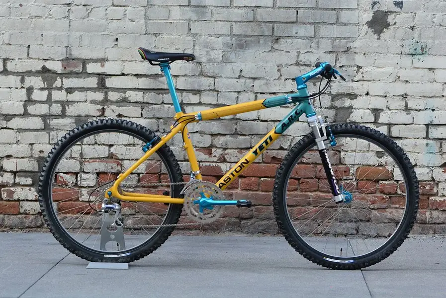

So you says yours is a 96/97, from the transitional period. Im wondering about the collars on the headtube. Mine has those too, and I don't seem to see those too often.
I'm planning on a full repaint and want to do the frame as correct as possible, since it costs a lot of money to paint it. I'm wondering if the decals like on the bike below are still correct for a 96/97 frame... Can anything about the built date be traced back from the serial number?
Well, the 1996 brochure still shows the "YETI A.R.C. EASTON" decals but many '96 frames came only with "YETI" decals. I read that at least in some cases they shipped the frame with "A.R.C." and "EASTON" decals not applied but still included with the user manuals etc.
So, these "additiona" decals are totally fine for 1996.
For 1997 Yeti moved to Troy Lee Designs' arrow decals and there were no "A.R.C." and "EASTON" decals anymore.
I think the frame's way cooler with the full set of decals like mine or in that photo so go ahead and make it such that pleases you the most.
