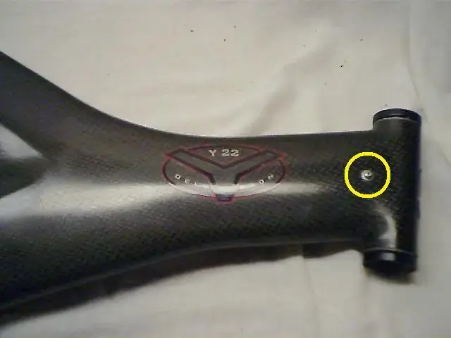

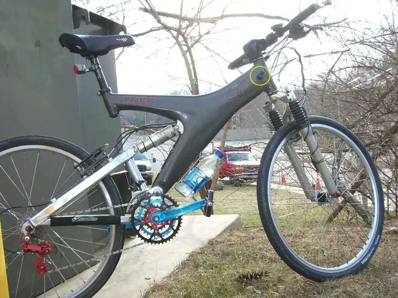

I mean the area directly behind the steertube where a bolt passes through the frame. This bolt attaches cable stops on one side (bike w/o stock remote lock-out rear shock) and on both sides on bikes that came stock w/ rear remote lock-out. The sleeve-area, where the bolt passes through the frame at this point, was apparently reinforced on bikes that came w/ the stock, remote lock-out feature. Confusing. I know. But I'm a tech geek and like to read about all possible alterations to bikes and their benefits/consequences. Mine seemed to function fine w/ the remote lockout installed before the seals failed on my rear shock. My concern was that I was stressing the frame, w/ the lock-out cable stop I had to install, on the lock-out side of the frame. I used a dura ace cable stop where there used to be just a clear plastic washer.
Here's how it looks after installing a cable stop behind steer-tube:
Hi dmccart2, I get what you mean now....those factory cable stops/guides that came stock on the Y33/ 50s with the external lockout shocks on the front end of the frames and the Y22s without the factory cable stop installed but with the hole on the drive side of the frame. Do you by any chance know the Max air pressure for those Stratos strata/ Pro shocks ? It would be very much appreciated if you could steer me in the right direction to any available online information or scanned copies of the manual if any. Just wana make sure I keep within the Max pressure as recommended by the now defunct Stratos.
