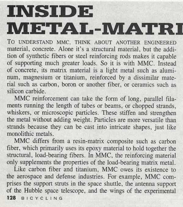

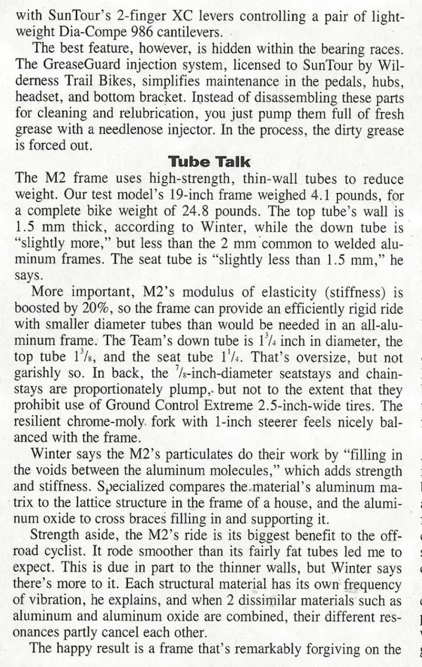

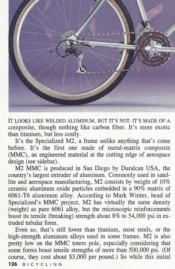

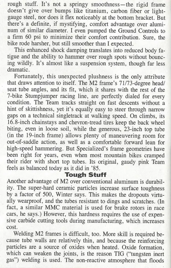

these ones:
they are cosmetically shabby now, but still work OK. They are the coil versions
Not in the right order but def worth a reading
Thank you so much for that! I shared them elsewhere, I think I have managed to get them in order, if anyone would like an easier read, check out post #439:

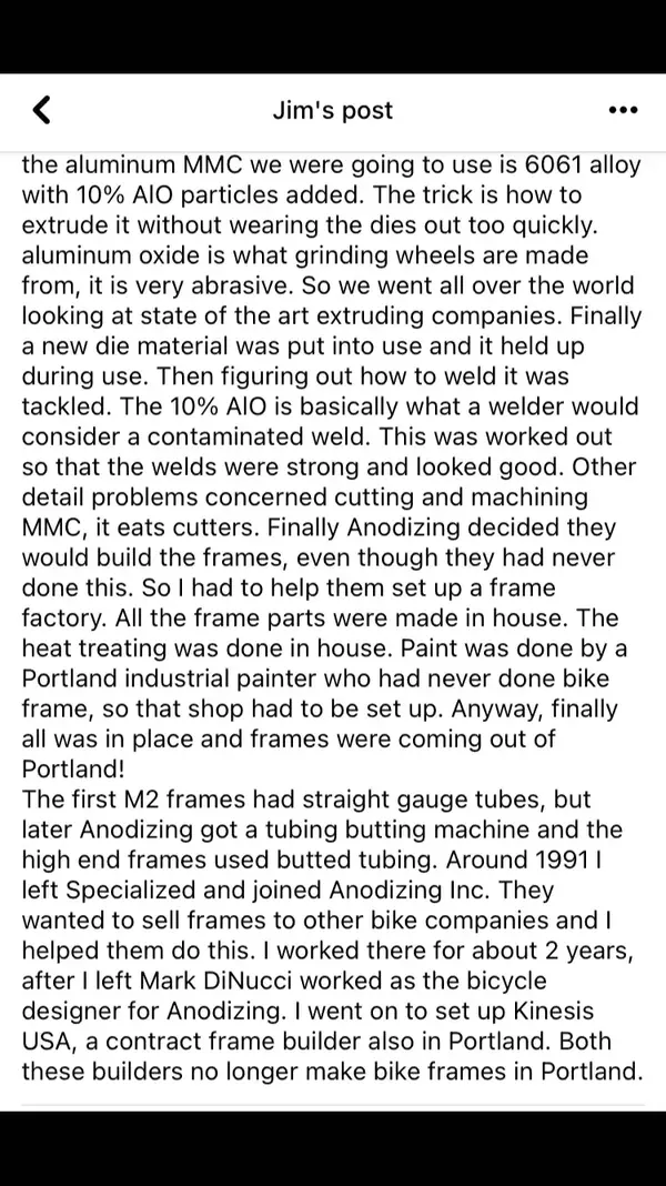

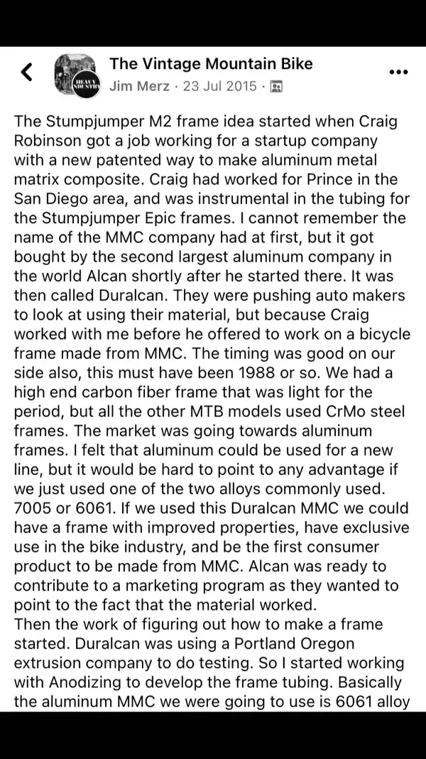

I was in such a rabbit with the technology of this frame that I tried to find out as much as I could.
Here is someone story from within Specialized:
