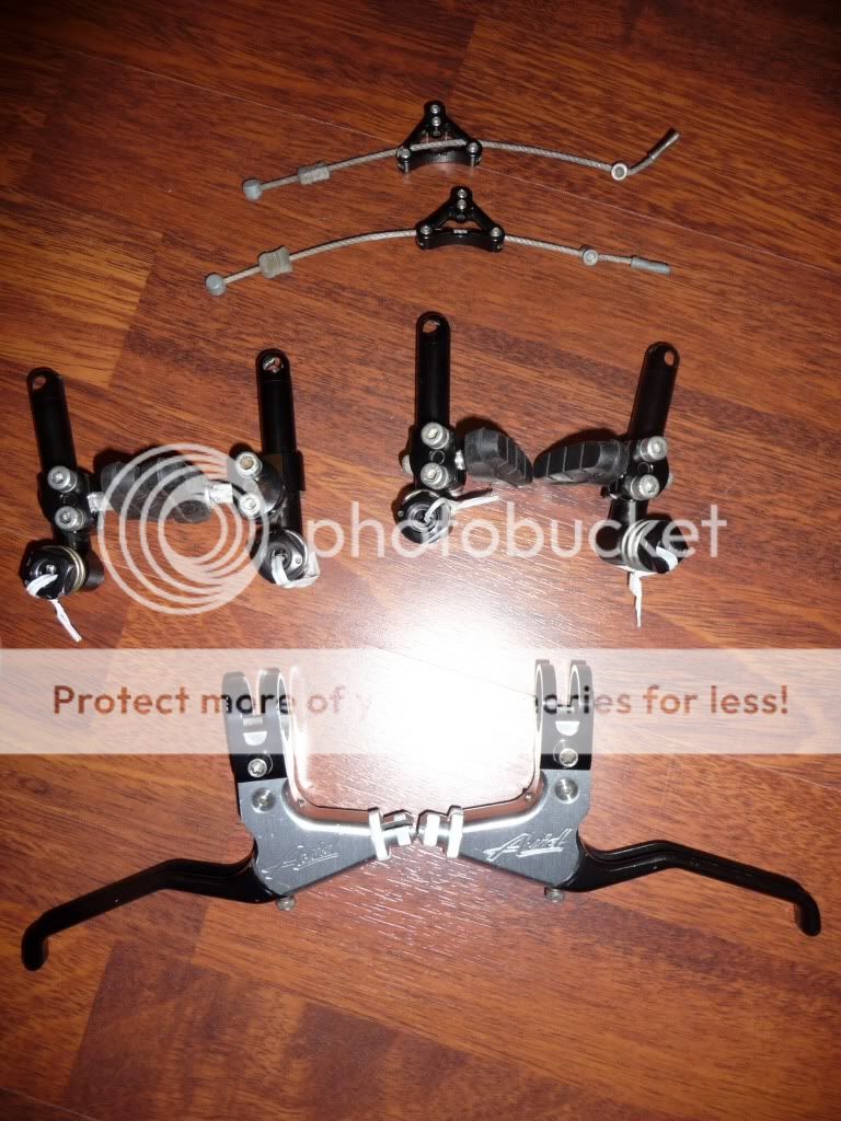

Got some nice brakes & levers for the XLM:
Avid SD Ultimates and Tri-Aligns.
But fork me, the Tri-Aligns don't seem to fit with the Pace fork! The brake arms interfere with fork's brake bridge. Does anyone happen to know how to go around this issue except buying a pair of brakes with different design (like Grafton, Critical Racing, ...)

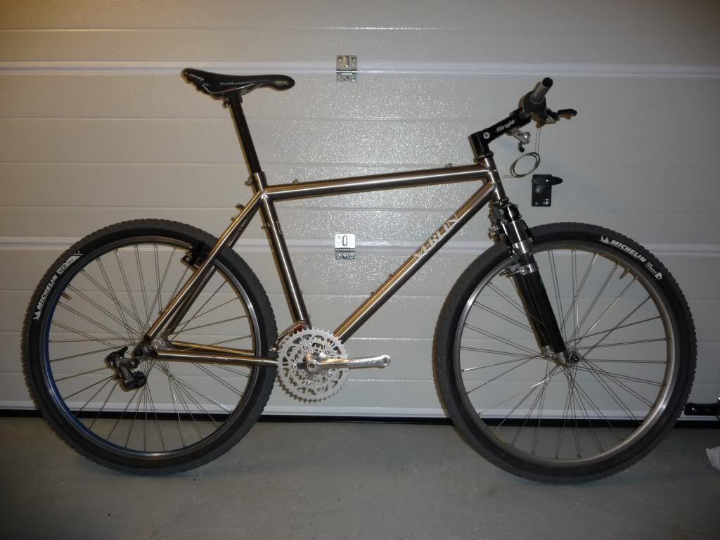

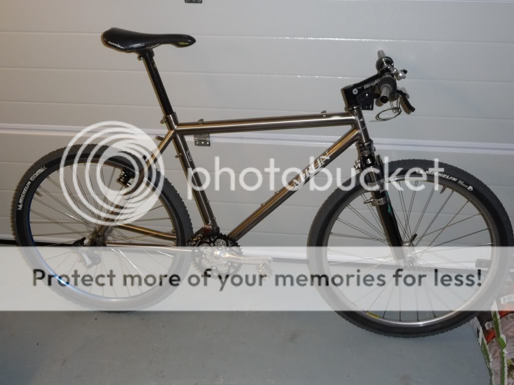

Anyhow, installed some preliminary wheels to see how it looks and here it is:
Will probably change that largest chainring to a black version, will probably look better.
How do you guys like the seatpost compared to my old Merlin's Syncros Ti? Which one would be cooler?
Looks great, although either black large chainring, or the Syncros Ti Post and a nice silver stem to match...
Changed the largest chainring to a black one - looks much better.
Tim will try to help me out with the compatibility issue with Pace & Tri-Aligns. If that doesn't turn out well, then I need to find me a set of Graftons or equivalent...
UPDATE: seems that Tim, the Pace Wizard, is able to provide me a set of new brake pivots with which I could use the Avid brakes. Yay! :)
