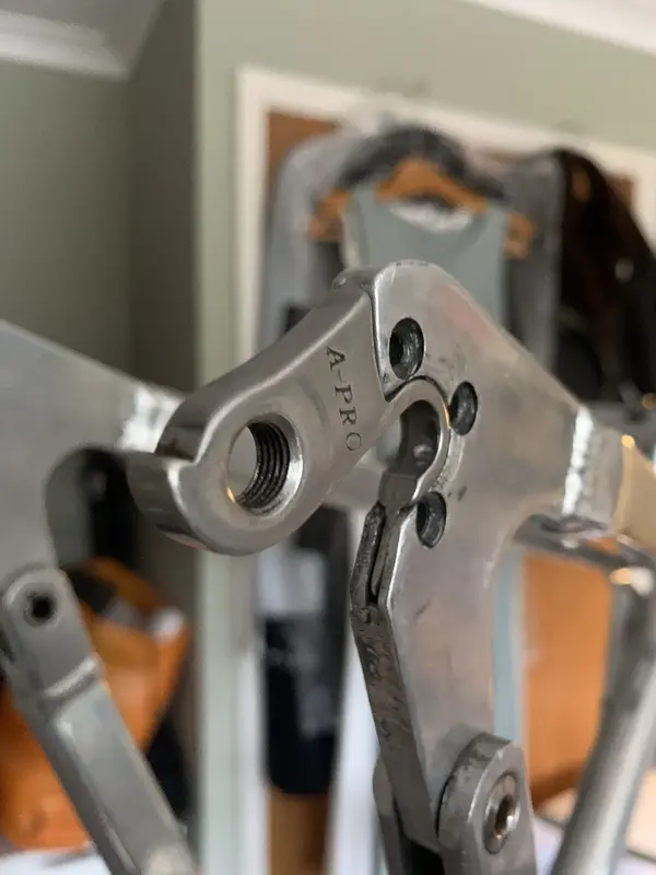

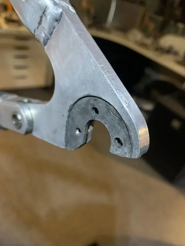

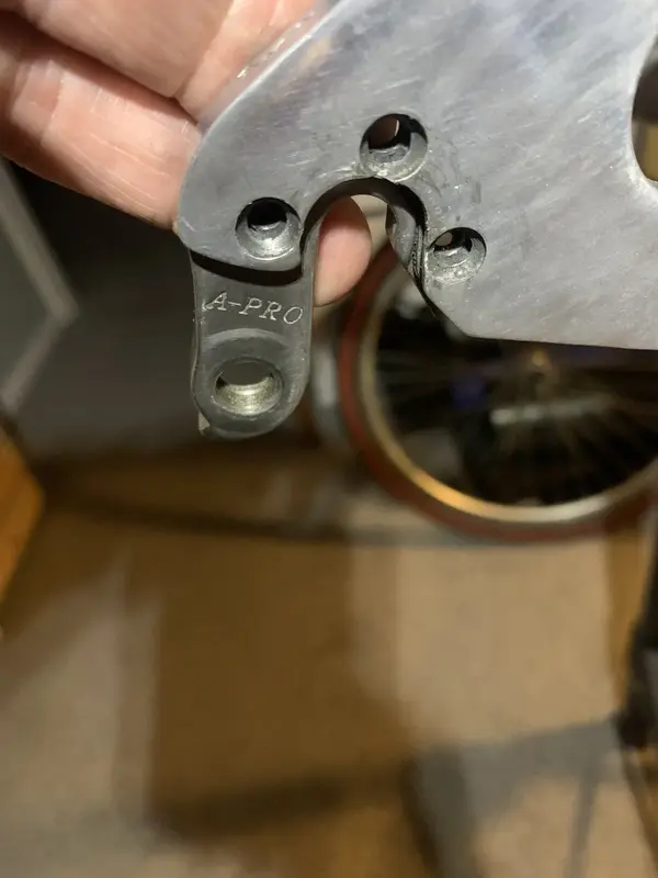

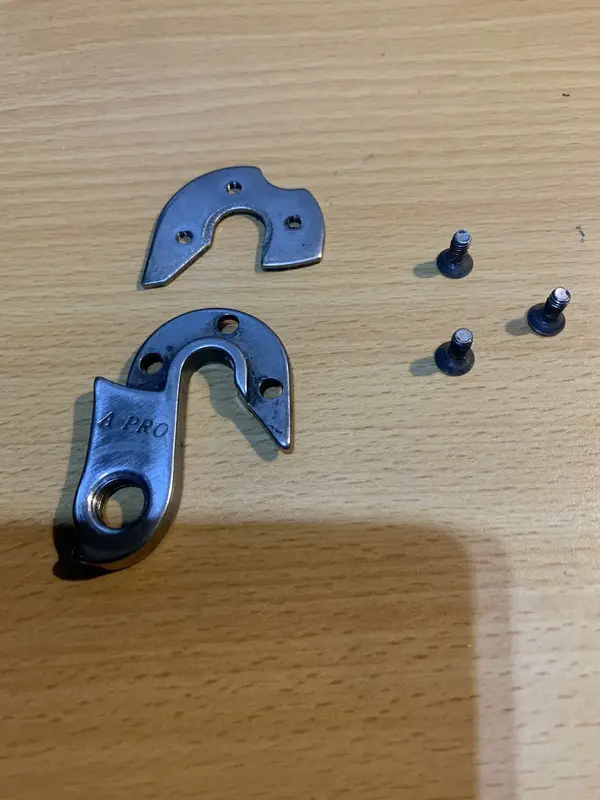

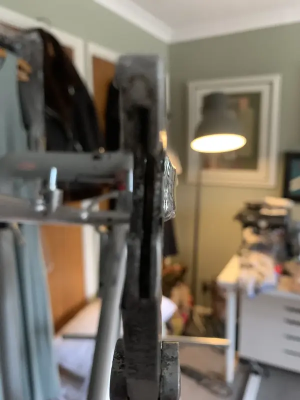

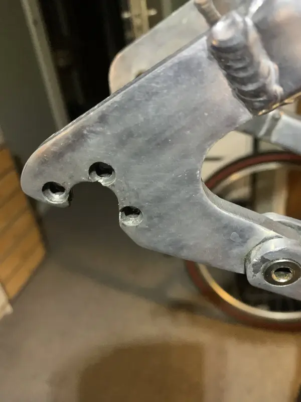

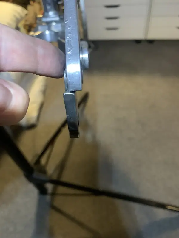

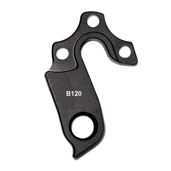

I am moving along slowly with my rebuild of this 1996 Marin Nail FRS. I bought the frame which had taped to the rear drop out the hanger shown in the images. For the life of me I cannot see how it fits. I'm thinking it is the incorrect part. I've also attached an image that I found on the web of an aftermarket hanger which looks very similar in shape. Unfortunately they are out of stock !! Am I right to think the one I've been sent with the frame is incorrect, or am I just being dumb? If it is incorrect, any advice as to where I can source a correct hanger which may be in stock ? TIA

Take away the spacer.
The actual hanger should fit flush.
Someone may have put the spacer in as they were running 130mm spacing rear axle instead of 135mm
EDIT
The hanger goes first, then the plate, the plate part has the thread for the screws by looks of it, it also has marks from the end of the hub axle.
So the hanger is sandwiched between frame and plate.
EDIT
There is no thread in the hanger or the drop out purely in the piece you say is a spacer. So without that, there is no way of holding the hanger to the drop out as the screws dont reach. Maybe I hust need longer screws? However surely the hangar should be flush with the frame when fitted. As you can see, it is recessed a few mm when fitted
Will the hanger fit into the frame drop out with a little persuasion? Then the "spacer" the might be a backing plate fit, with the screws in from the front?
I had one on a specialized that was a real tight fit
Issue resolved......Of course there is a slot in the hanger to accept the dropout. Once slid in the plate fixes at the back no problem. Hard to focus in image 1 showing the slot, but image 2 shows the hanger fitted
