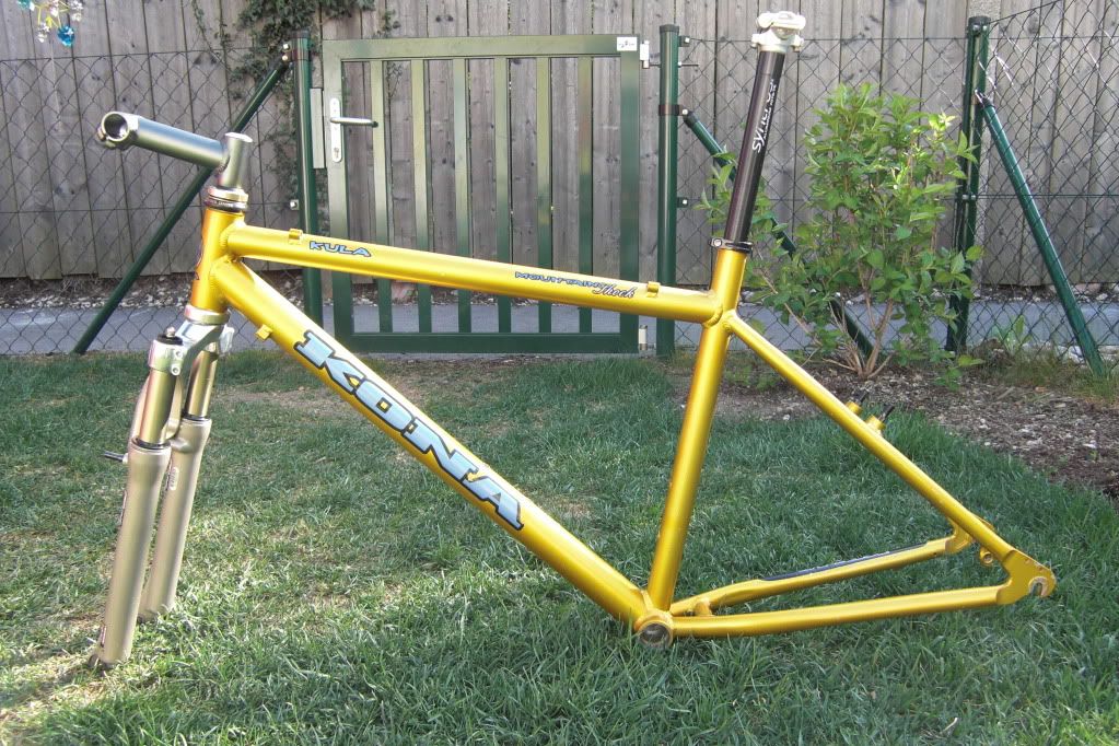

after a long search I found a decent 96 Kula on German Ebay :D
in 96 when I had the choice between the Explosif or the Kula, I choose to buy the Explosif, but found that the Kula was also great to drive.
so after some years I wanted to have also a Kula and was looking for one, but they do not appear very often, finally I was lucky and got this one:

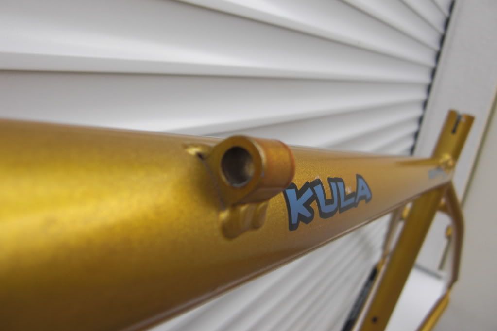

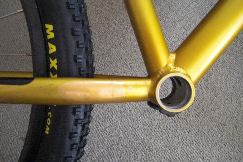

frame is quite nice, except chainsuck and some paint chips, but no dents and the der.hanger is straight.
its one of the earlier frames, build in 95 for the 96 modelyear and does have only mounts for Maguras.
will start to repair the chainsuck DIY and thinking about what parts will go on it, so in fact this bike will be my first project bike :)
chainsuck closeup :?
filled and sanded the area and after some testing with various Humbrol Enamel colours to match almost the Kulas Gold I managed to get this - not really perfect, but OK for me and the bike's a driver, so what.....

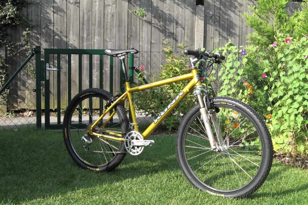

:D FINISHED :D

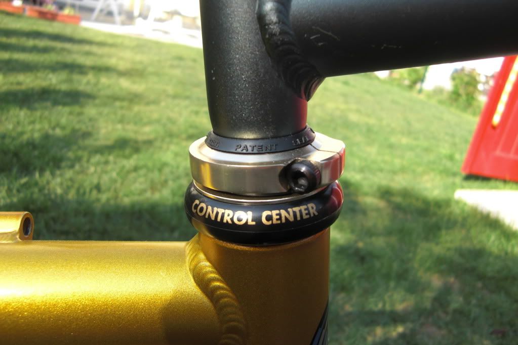

Headset: NOS Kona Control Center 1 1/8" treaded

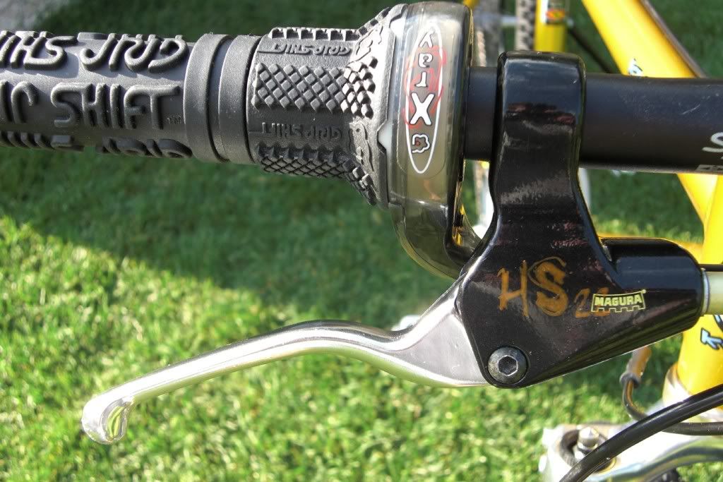

Brakes: Magura HS 22 Hydraulic
Brake
Pads: Magura for ceramic rims
Brake
Cables: Magura plastic tube
Cantilever
cable
hangers: -
Brake
Levers: Magura HS 22 alloy
Shifters: Grip Shift SRT 800X-81-3 X-Ray

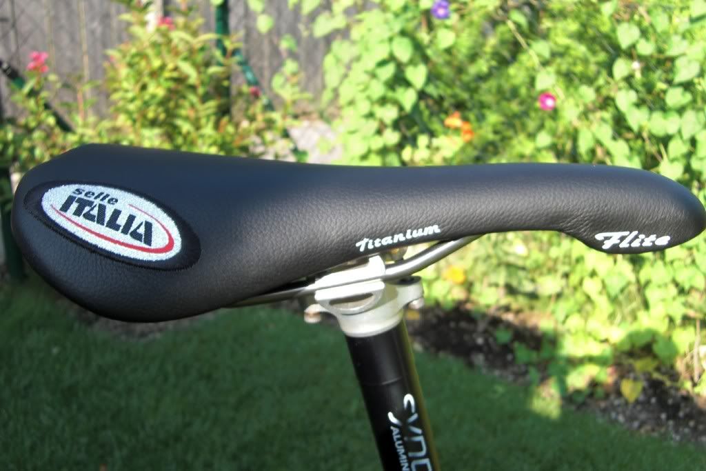

Saddle: NOS Selle Italia Flite Ti

Weight: 10,9 kg / 24,03 lbs.

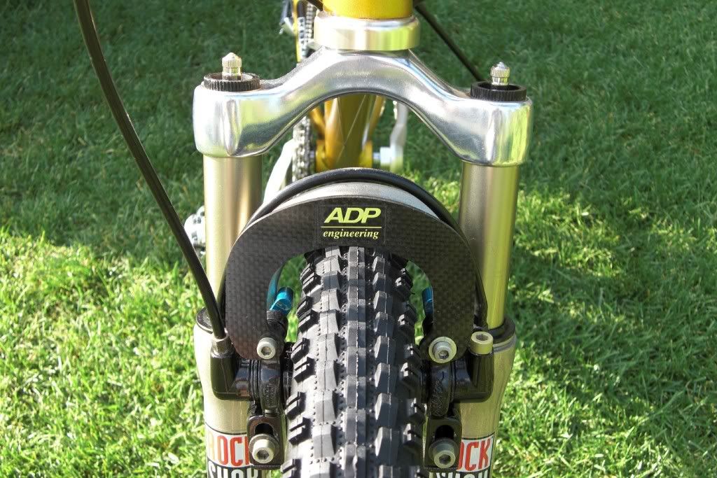

ADP carbon-brakebooster
Magura alloy bolts set
"AC fingers" for the front Magura set up
