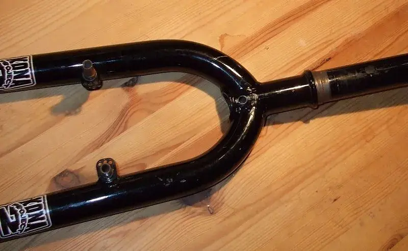

Anthony":386pd7vt said:
This is what the 44cm version looks like.
I think the penny has dropped - is the 44 cm version (and its perceived ugliness) due to the headset lower crown lip sitting someway off the top of the crown?
