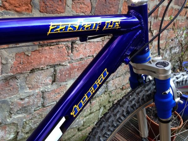

Frame: 1996 18" Ink Blue Zaskar

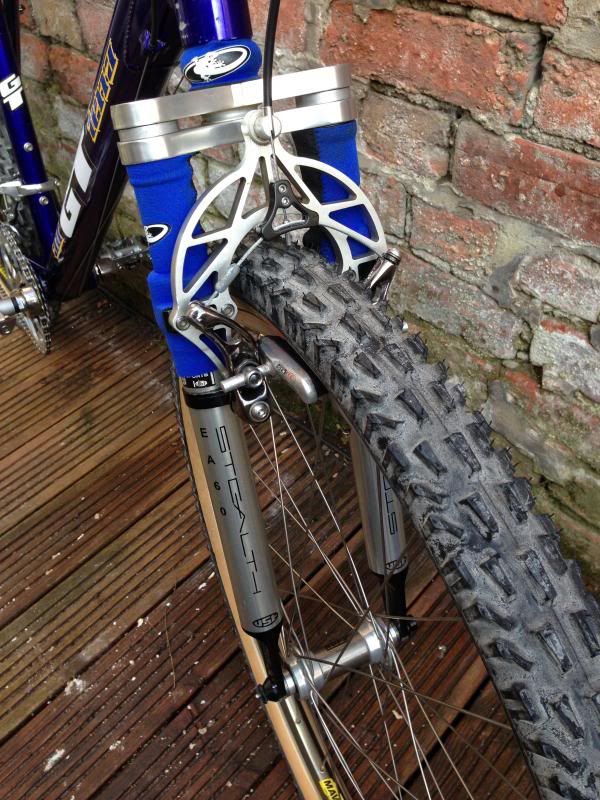

Fork: U.S.E. EA60 Stealth
Headset: 1" Stronglight (with reducer shims)

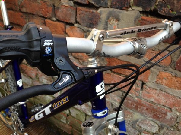

Stem: 135mm 1" quill Club Roost I Beam- (Could do with a 115mm)
Handlebar: Club Roost Comp 2 Riser
Grips: Sachs
Barends: None

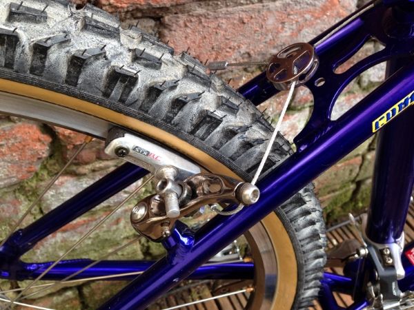

Brakes: STX RC Cantilevers
Brake Pads: STX RC
Brake Cables: Shimano
Cantilever cable hangers: Black alloy front silver Mojo copy rear
Brake Levers: Dia-Compe SS5
Shifters: Sachs/Gripshift Wavey
Front Derailleur: Shimano XT M737
Rear Derailleur: Shimano XT M737
Derailleur Cables: Shimano M System
Cassette: Shimano XT M737
Chain: Sram Power Chain

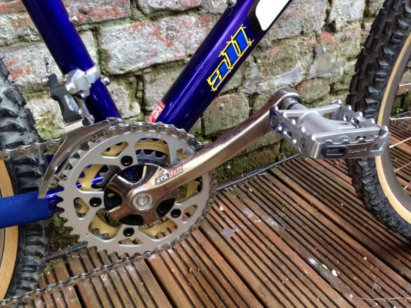

Cranks: Shimano STX RC with Pace spider adapter
Crank Bolts: Self extractor
Chainrings: 40T Stronglight, 32T Vulete, 22T FSA
Chainring bolts: Shimano black alloy
Bottom Bracket: UN52 78mm/110mm
Pedals: Shimano PD M324
Hub Skewers: Black security
Rims: Mavic 217 SUP UB Champagne
Hubs: F; Hope Suspaension R: Shimano XT M737
Nipples: Alloy
Spokes: DT Stainless
Tyres: Panaracer Smoke Dart
Tubes: Continental
Saddle: Flite Ti (Red Label)
Seatpost: U.S.E.
Seatpost Binder: GT?
Weight: No idea!
