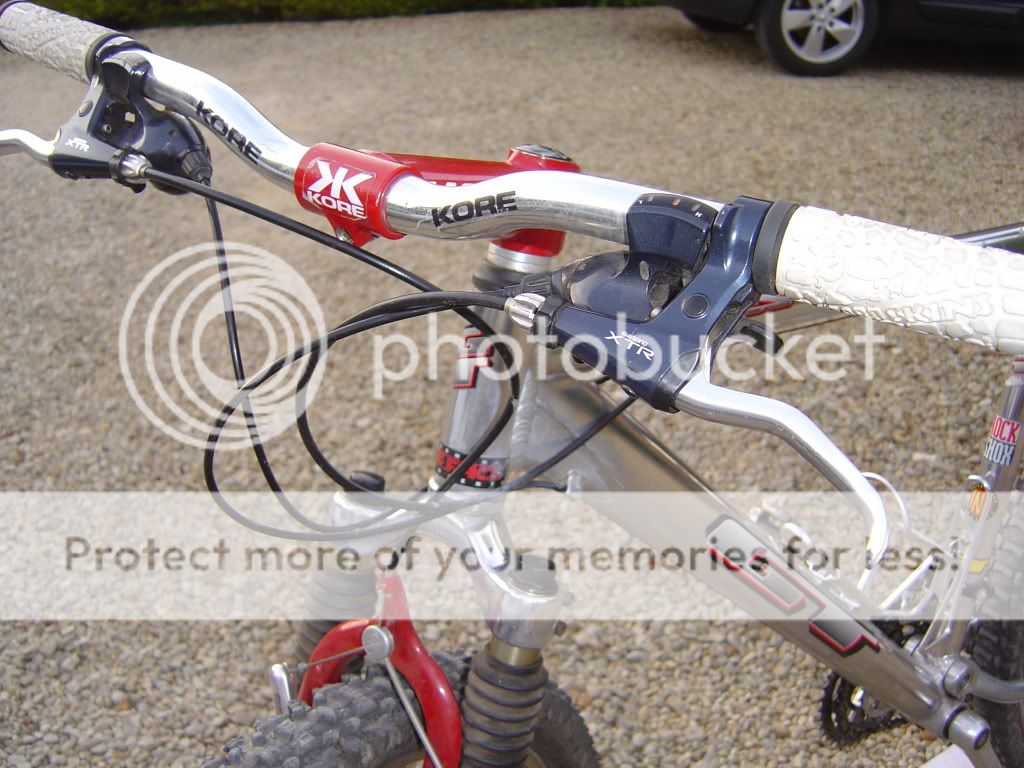

Anyway here are some rubbish pics I just took quick, Its basically as I picked it up apart from a quick front shock overall and quick service. Bit dirty from maiden retro FOD meet , As usual i got plans 8)
In 1996 Shimano introduced the "new" XTR which included the V-brakes as you mentioned. My memory is a bit fuzzy but somewhere I have a 1996 GT catalog. Those are not the original decals, not the original fork, probably are the original wheels, not the original bars, not the original seatpost or seat. The team LTS frame would not have had a cantilever brake post on the seatstays if I recall correctly. I used to know how to read the production date on the frames. If that is a 1996 front triangle it is probably a 1995 seatstay. The decal kit looks like it was from 1997

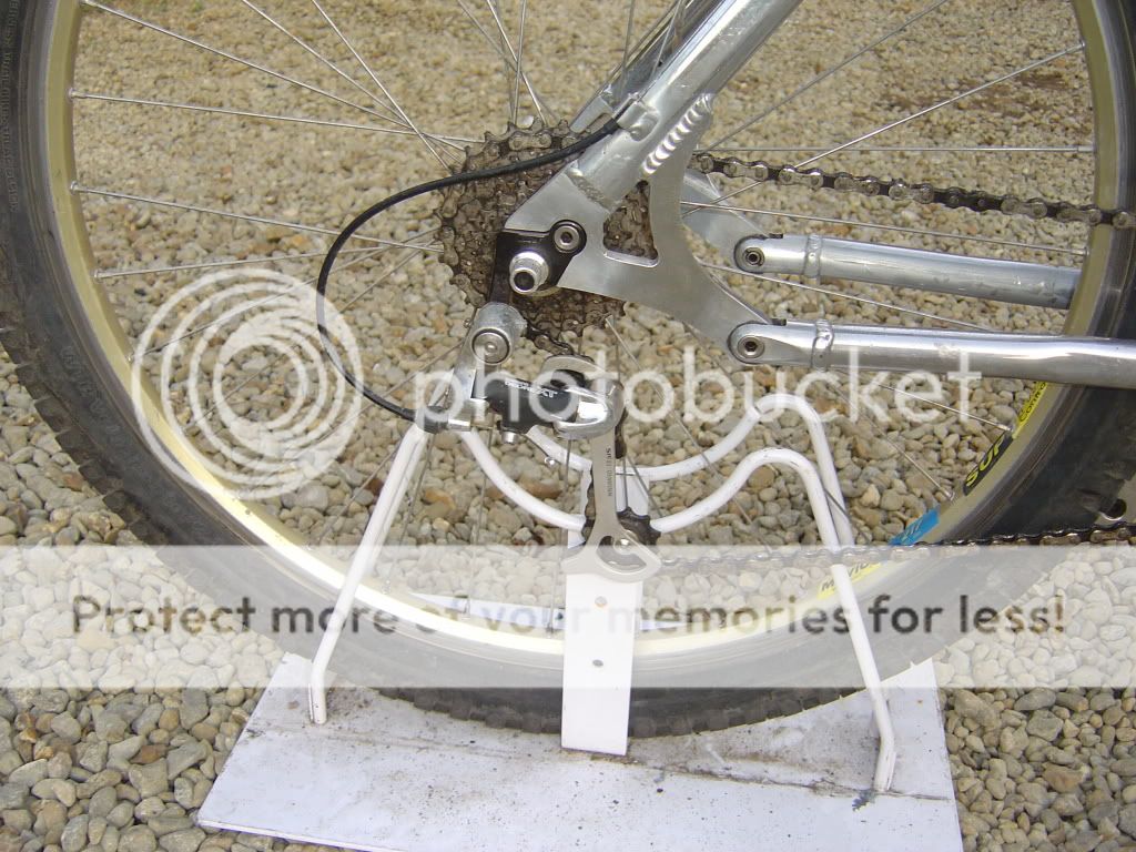

Shimano did indeed bring V brakes into the market in '96, but bear in mind that a '96 season bike would have been designed (and often built) the year before, so in '95 - therefore canti's were still default. Also we need to take into account that V brakes were an upgrade for most, so manufacturers still ran canti stops to allow for flexibility - much like we saw later with canti bosses and disc tabs on frames. If, for instance, like me back in '96 you bought an LTS frame, but didn't like V brakes/already had some high-end canti’s, you'd still have the flexibility. I ran Onza HO's on mine for example. So they certainly did have canti stops in '96:
Not mine, but it shows the rear end nicely (oo-er)! You can see the change to the downtube gusset and single bolt dropout nicely as well. For '97 the front end was unchanged, but the rear was quite different.
With regards to the year - it's a '96 frame, going by the gusset, link plates and rear shock. A standard '95 LTS would be running the Fox Alps shock, a '97 would be running a RockShox Super Deluxe (or Coupe etc...) - with the shock body at the top, and a red spring. The decals should match the ones in the image above for full retro completeness if that's your bag.
The 'Team' moniker doesn't really denote anything other than the catalogue spec incidentally - if it's an LTS-1 or a Team LTS prior to the '97 it'll be a 6061 aluminium frame, the finishing kit was the only difference, aside from the gusset placement. The only thing that bothers me is the serial - are you 100% sure that it's not starting with '0196...'? I'd imagine the '97 LTS production run would have started by then, with the 'Trunnion' style top linkage.

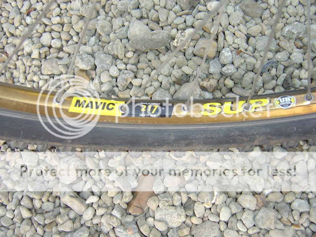

I'm not sure I would agree with it being built up from a frame because those look like stock wheels and gold 217's were an OE product, at least they were here across the pond. I live in California. That does appear to be a US built frame as all frames at that level and time period were. Either built in California or Colorado at their custom shop.

wheels 217 m900 rear tioga (sticker?) front

Kore stem

Due to the late production of 11/96, we know it's actually a 97 model year frame. Due to the serial number and 6061 we would know it's USA built. V-and canti bosses are the same so you can't really go by how it's built up...may have been started from a frame set. Is your upper rear link titanium or aluminum? Appears titanium. That link was not used in 1997 model year bikes so it's appearing to me that someone has mated a 97 front end with an older 95 or 96 rear end.
