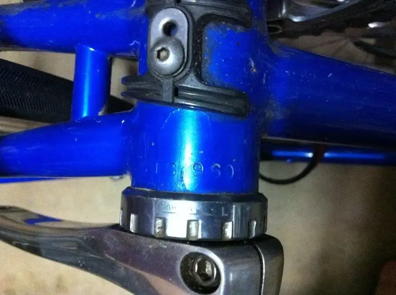

You sure it's not GTE 9602?
Its GTS - See attached image, hopefully you can see it clearly.....
