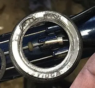

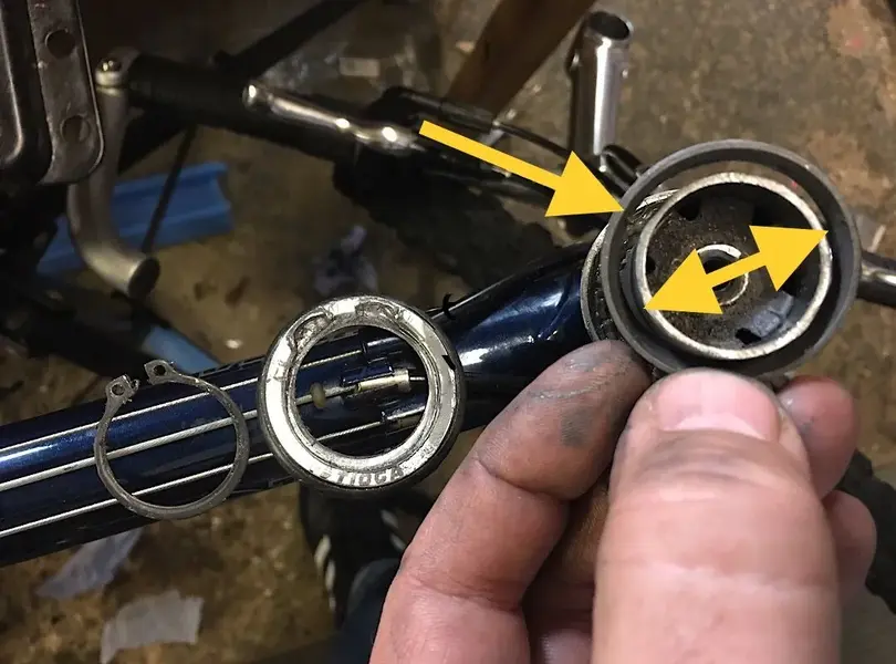

I noticed a slight movement had appeared in the head stock after my last ride, so today I thought I’d have a quick look to see what needs sorting. Now I’ve had very little to do with un threaded ahead steering tubes before and always thought that I was missing something, all other changes on bikes I can understand, most have made some improvement (to a lesser or greater degree) but the unthreaded ahead tube? Why? Just why? I can only assume it’s to save money in mfr because the result is a poor replacement to a system that locked the fork and races together then allowed the stem to be adjust as much as required and with one turn of a bolt. Bloody simple and brilliant.
Anyway, getting back to my problem. After I removed the top cap (what does that do?) then the stem clamp, then the brake cable hanger (3 bolts so far) I found a circlip hammered down into the soft aluminium top of the ball race housing/cover. After removing the clip and cover I found the race seems to be the wrong size, it’s internal diameter is 1 1/4” where as the steer tube outside diameter is 1 1/8”.
In my ignorance of these units I’m not sure if this is the problem or if I’m missing another erroneous part?

The top cap screws into the star nut that is inside the fork steerer. This tensions the whole assembly and keeps it stable. So when reassembling, tighten the top cap before tightening the two stem bolts.
Absolutely no idea what the circlip is doing in there. I'd suggest completely taking the forks out, laying the headset parts out in the order that they came apart and posting back on here or googling the headset to see if anything is amiss, assuming the headset has a part number or other identification you can use.
I must admit, I also prefer threaded headsets.

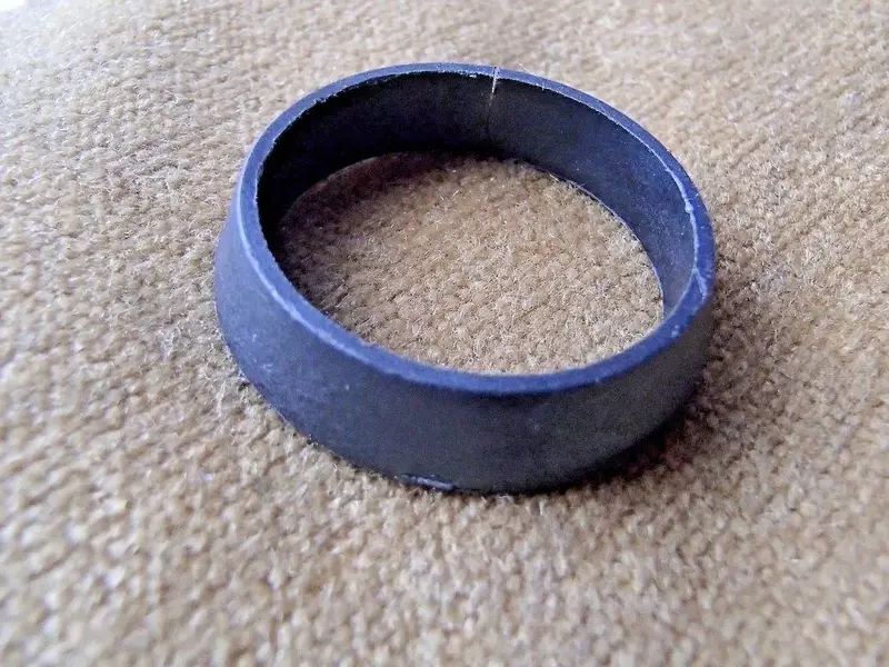

I think the part I'm missing is a 1"1/8th shim, perhaps it got lost during service by the previous (now deceased) owner…. And made do with the circlip to hold it all together, bit odd though as I don’t see how it would really help…
There’s one on e-bay so I’ve chucked in a bid.

oaklec":li1rjsaa said:
Forget that last post, the shim slots in to take up the slack between the piece you are holding and the steerer tube.
