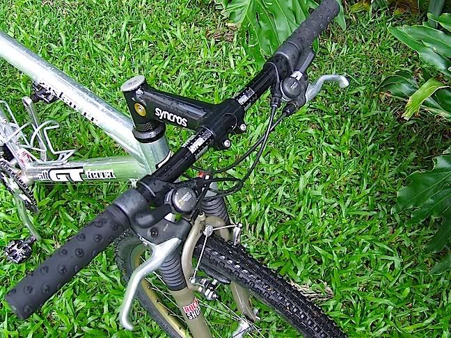

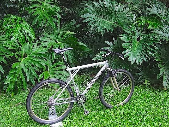

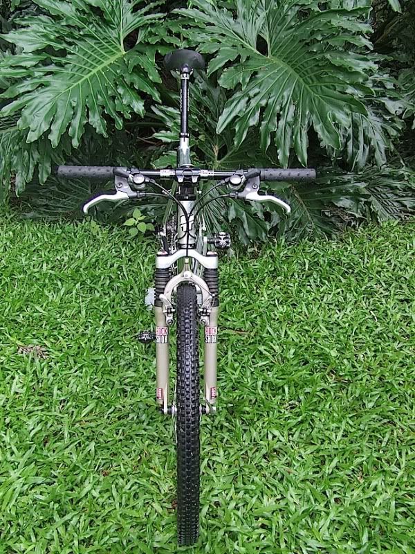

Update time. So changes to a few details;
•XT Thumbshifters
•M737 SPD Pedals
•Syncros Cattlehead 145mm (thanks racer-x) and 27.0 Post
•Hyperlites
•DX Levers that i found on the side of the road (literally) but to be replaced w some M900 levers shifter mounts removed (thanks GT-Steve)
pretty happy with the setup and ride now, and have been riding it an awful lot. like close to every day.. :D
Great looking bike you have there,think a zaskar should be in everyone's man cave!
I like all the photos of how it started through to now goes to show a build is never truly "finished!"
Really nice understated but it still stands out a mile!
I love it 8)
