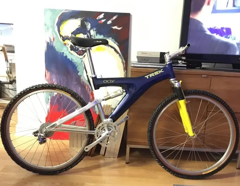

I found this thing on the local craiglist the other day..the guy was asking $130 cdn ($98 US) with no wheels..as the damper in the fork is worth about that I called and said I would take it sight unseen!

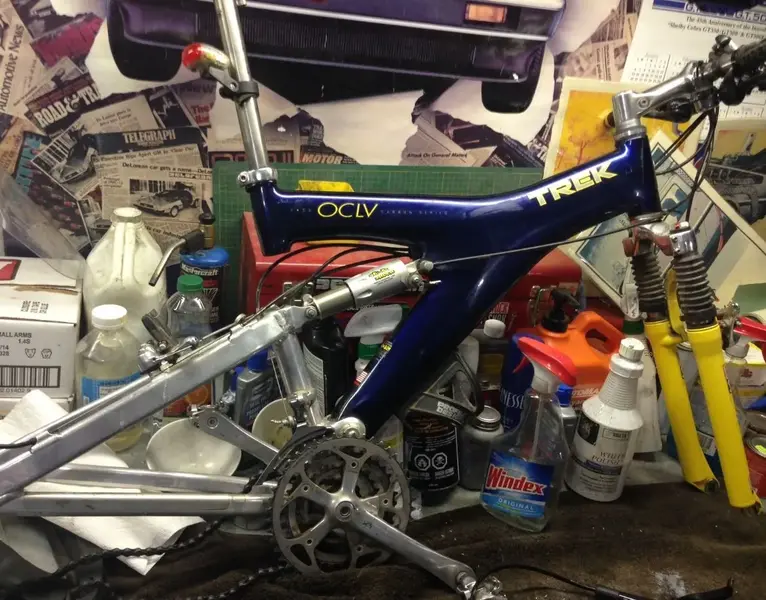

it is no garage queen but was 100% complete and original..to date I have:
-totally disassembled and cleaned, polished, regreased.
-rebuilt the fork with new bushings..it actually had a risse gem cartridge and speeds springs!
-fixed leaky valve on the rear shock..just a new o ring.
-found some appropriate wheels, rebuild the hubs, and installed the correct tires
-dropped it out of the bike stand due to the seat binder not being tight enough and scratched it (I screamed quite loud)
need to fix the left shifter, and it should be added to my wifes growing collection of bikes! I will have under $200 into it! not bad I think.

you can call risse racing about the shock. they might have some spare fox alps..make sure to figure the correct eye to eye. worst case you can buy a new risse shock for it..but at $200 it might be best to get an entire donor bike on ebay, use the shock and part the rest out.
I always replace the bushings as they will instantly destroy the ano on the stanchions once their teflon wears off. it seems they are available here..old bike stores should have the tools to replace these..you will get a deer in the headlights look from any employee under the age of 35!

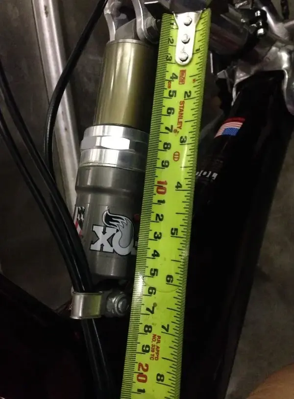

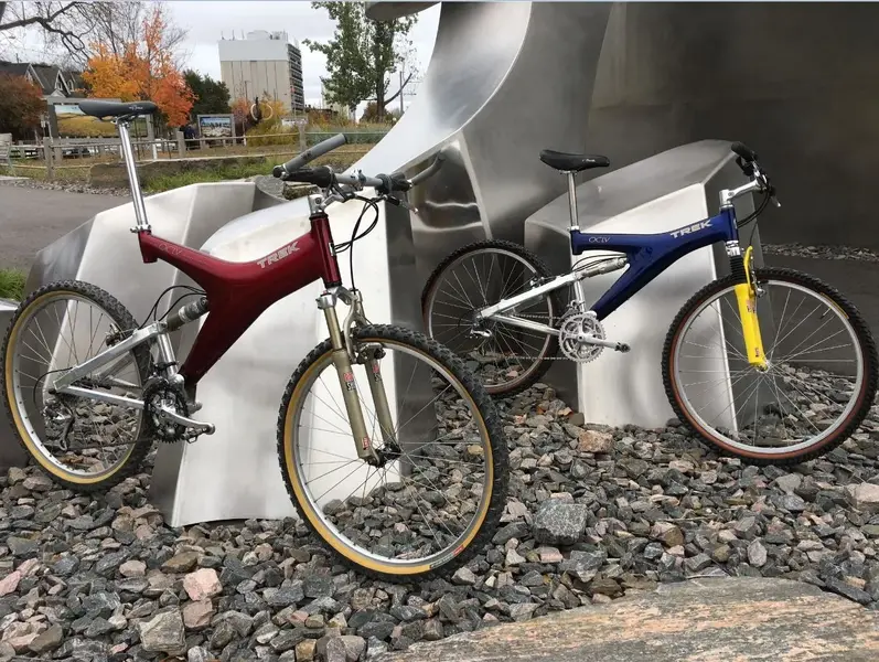

I measured both the size small 1995 y33 and my size large 1995 y22 and the eye to eye on both is 16.5cm..out for a ride!..
