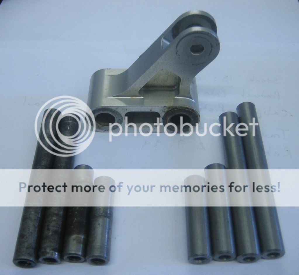

Previous pivots should have been 10mm diameter but were worn to 9.6mm in places! Hopefully with new pivots, new bearings and some shims the back end slop will be sorted.
If only Sunn could sort some spares.
Here are the new pins on the right, old pins on the left and part of the suspension linkage showing the phosphor bronze bushings.
I would like to know if anyone thinks I would get better performance out of an Iglidur Polymer Plain bearing? And also possibly changing the material for the pins? Aluminium or Stainless perhaps?
Does anyone know what model Iglidur plain bearing is already used on bikes?
http://www.igus.ie/wpck/default.aspx?pagenr=5182

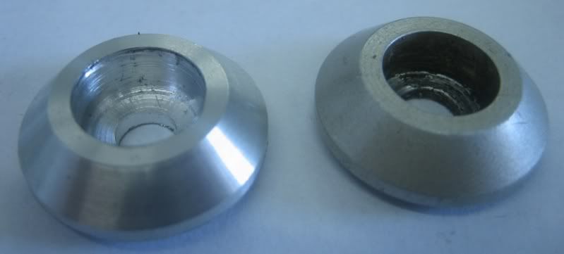

So fresh from the lathe again we have a new main pivot bearing cover. I only ever had one for this bike and am glad to finally have a complete set. New one on the left, original one on the right. The new one just needs a little de-burring to do on the inside.

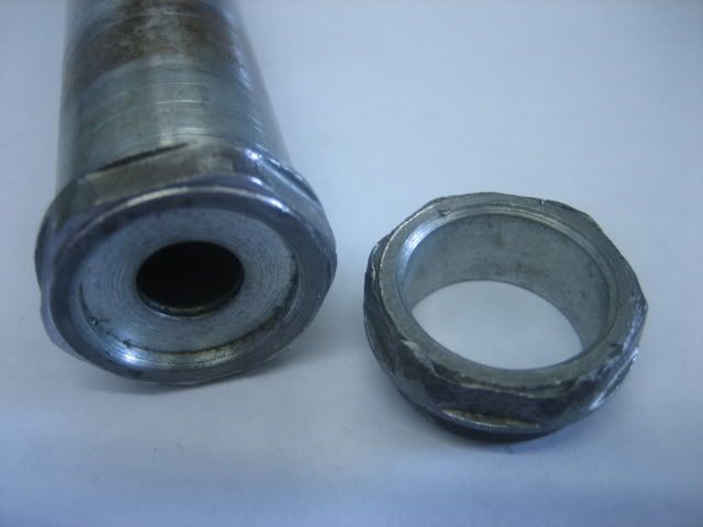

Speaking of which, I have started de-burring the front axle bolts which have been heavily used. I only got to take a couple of cuts but you can see one face is a bit shiny(ish) the uncleaned bolt is on the right and the partially cleaned one on the left.

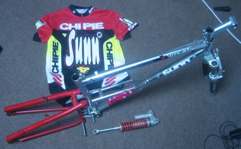

Finally as I had the bike out test fitting the new pins I thought I'd take a pic in its fully disassembled state, with an old Sunn jersey for good measure. The bike is hard to picture now as it's partially polished and the chrome is very shiny.
