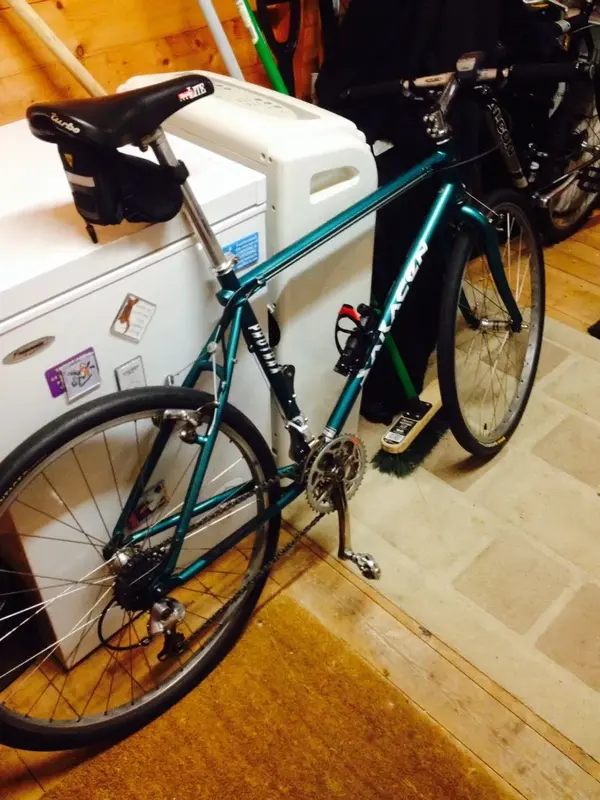

Funny.............I bought one of these on Wednesday.
I don't like the look of the length of that seat post.
Mine has a little issue with it being seized in at the moment,I fear drastic measures will be needed.
