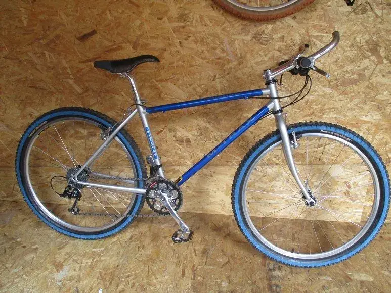

mtrax
hi, nice frame ive had my `94 1000 from new so am quite fond of it, bit heavy in standard spec,alivio etc but my advice would be to build it light as possible on a budget. i rebuilt mine starting by swapping out the original Raleigh steel forks for some gt cromo rigids and saved 250g, then changed the stem, bars and seatpost for alloy ones. lighter groupset stx rc/deore lx is good value. i managed to get my lx specced one down to 26.5lbs.
the rear triangle is where all the weight is due to it being made of hi tensile steel not reynolds k2.
still rides really nice pretty fast.
cheers
andy

Hi Wayne !
I'd finished the 'Dry Build' in about 20 minutes after getting home from picking it up. I had to wait for some new A-Headset spacers to arrive until I could complete it proper but it's done and dusted now. The missus is at work on it today actually.
I love the fact that it's got Deore XT / Mavic wheels on it and the panniers cost more then the bike itself !!!
