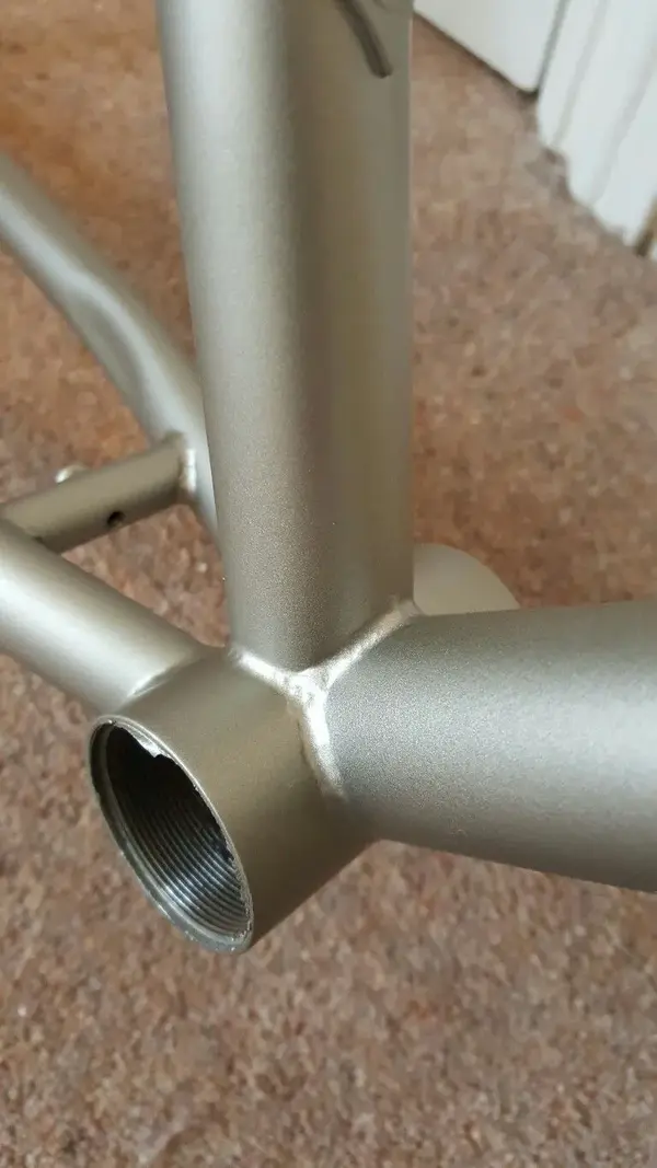

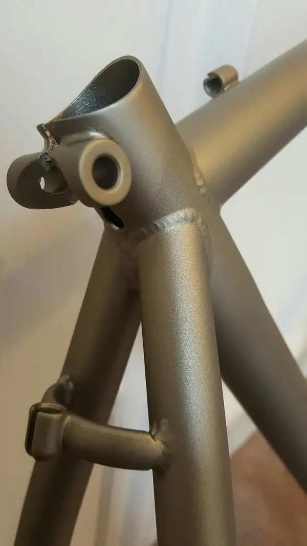

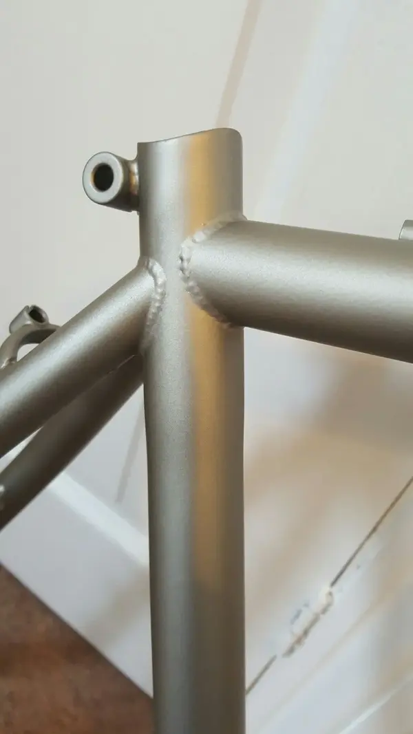

Spray painting
Having chickened out of finally painting the frame for a few weeks i finally bit the bullet. After trying several times to get Halfords to mix me some paint i ordered some from Riolett custom Aerosols. They sell 2k paint in 400ml cans that includes a hardener so more durable than 1k paint that you pick up in most shops.
They matched the paint code (Lexus/Toyota Dorado Gold 587) and the cans arrived less than 24 hours later, great service.
Having primed the bike really nicely i decided not to fine sand it as i wanted to maintain the slight texture that the primer had to create the satin look of the original paint. You select the gloss level at ordering (i went for satin at 30% gloss)
I set up a painting station in my shed with completely inadequate ventilation, instead opting for the deep breath, run in, few sprays, run out of the shed to breathe technique employed by absolutely no professionals. Don't do what i did kids, i am not a role model. A 3M mask no doubt offered me little to no protection.
The riolett aerosols had a vertical fan nozzle which over 2 cans and 4 coats didn't splutter once even when i sprayed right to the end of a can, can't recommend their paint enough. Keeping your can vertical is the best way to avoid spluttering anyway.
One v light tack coat then 3 (ish) heavier wet coats with 25min inbetween as it was a cold day. I paid particular attention to high stress areas including the chain stays, bottom bracket and dropouts.
I then left it in the shed to cure until it got dark (and cold) then transferred it into the house as VOC had reduced and needed the warmth.
Stupidly rested it against a plastic box which scraped 1mm of paint off the top tube.
So that's it! It was a great colour match to the forks which i have decided to leave for the time being as no rust, original decals and i got the bike to ride over winter.
I will leave the bike for as long as i can to cure before assembling/riding it.
Seriously, don't spray 2K paint in an unventilated area, solvent abuse can kill with one hit, stay safe kids.
