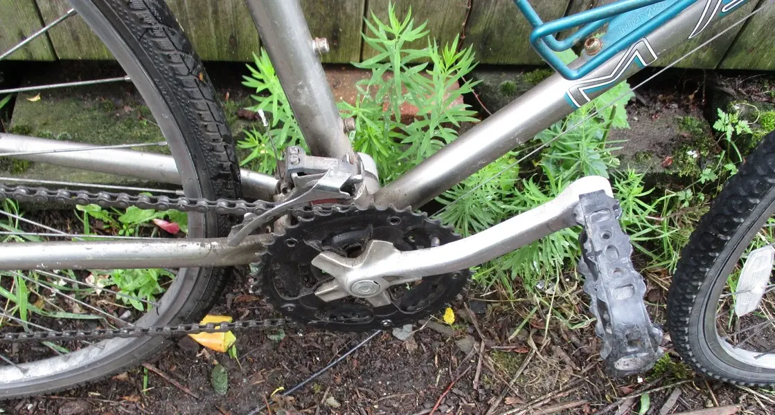

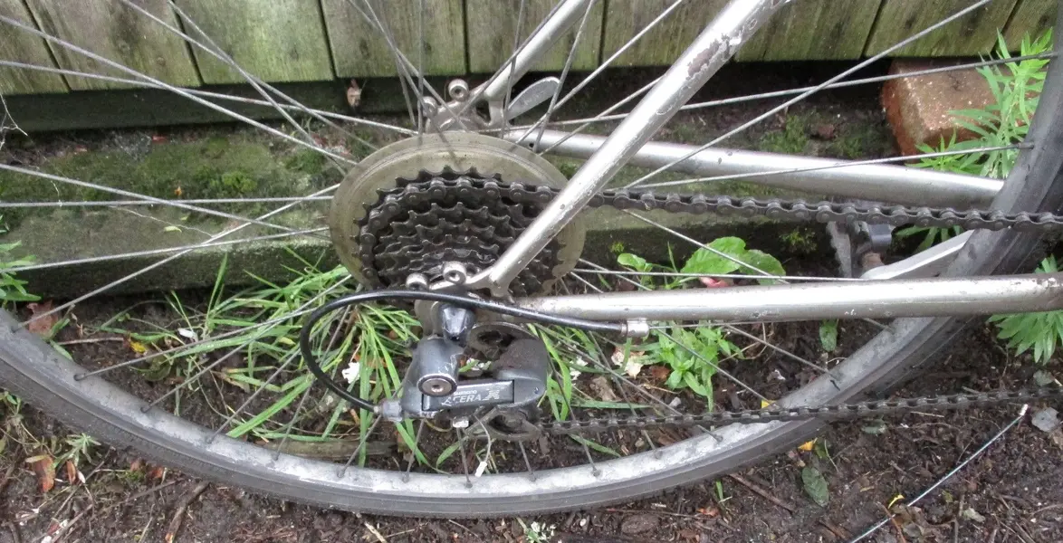

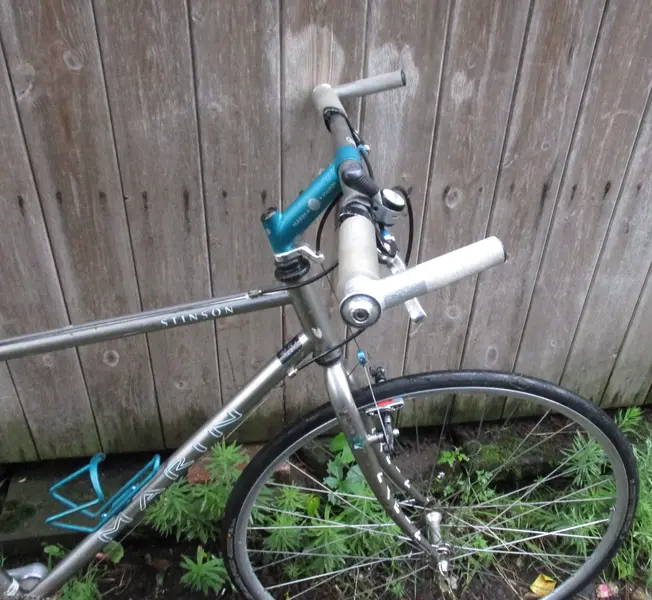

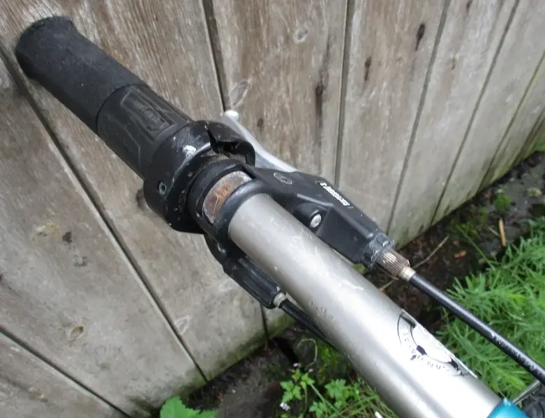

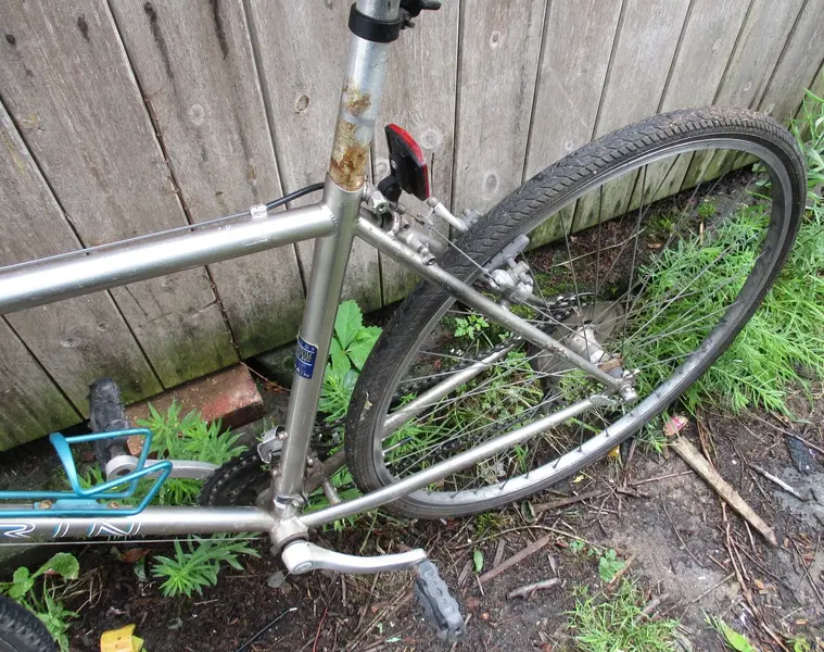

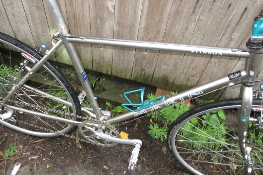

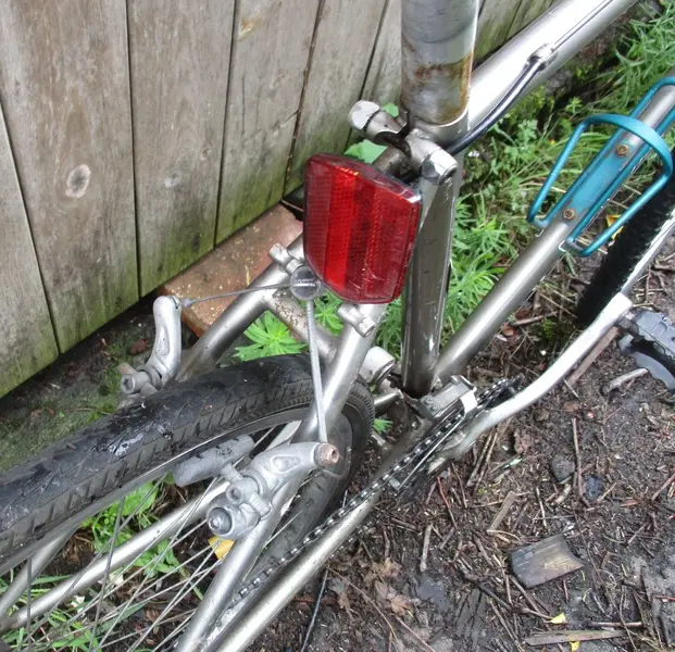

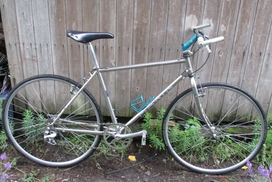

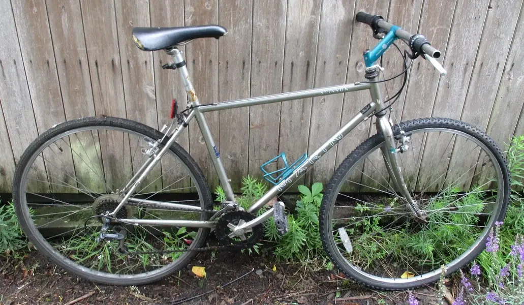

After picking up a Charge Plug recently I have been enjoying riding it but being single speed it has it's limitations. So I have been looking out for something with a similar geometery, then this ratty Marin Stinson turned up on my local Facebook selling pages for £80 so a quick haggle I got it for £60.
Same triple butted chromoly frame as the higher specced bikes of the same year, came with heavy and basic Acera X components and wideboy tyres. So out came the Indiana Jones-esque spares box, several hours and many rain showers later my streetfighter version emerged............
Now to the pictures :D
First the before pictures :wink:
Couple more before pictures.
Now the fully pimped after pictures, I will be putting cable ends on tomorrow as it was getting late and I was getting a bit cranky. Full specs later :D
