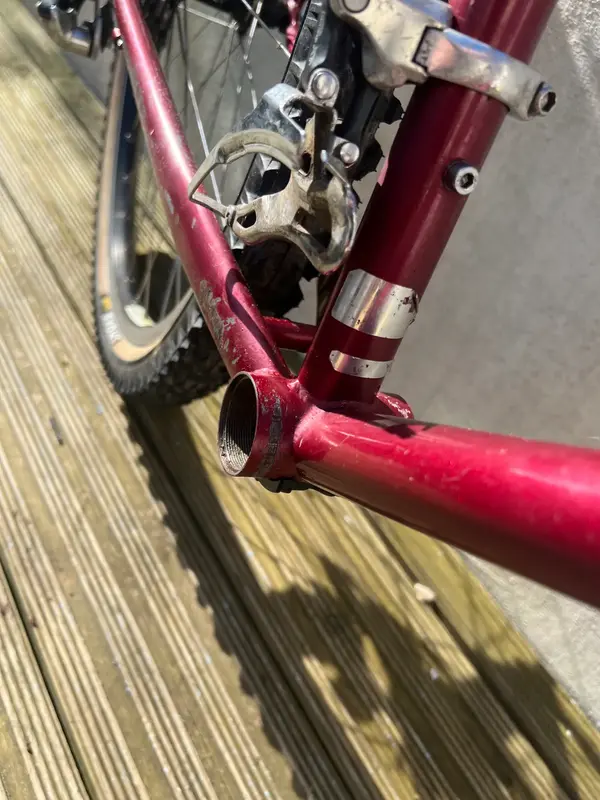

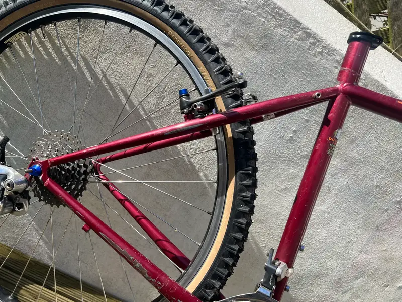

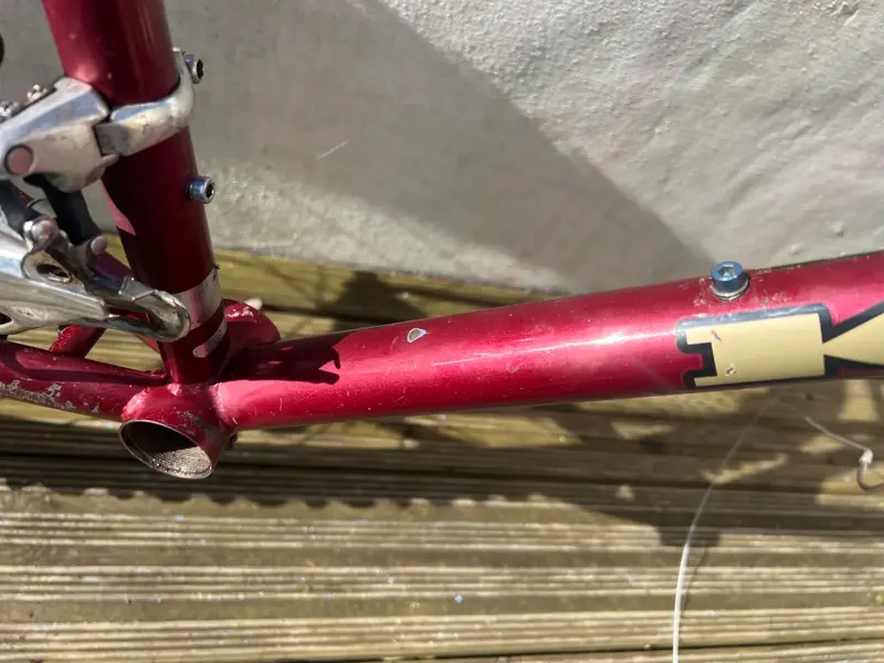

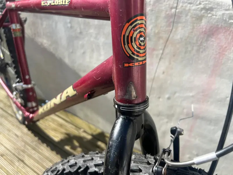

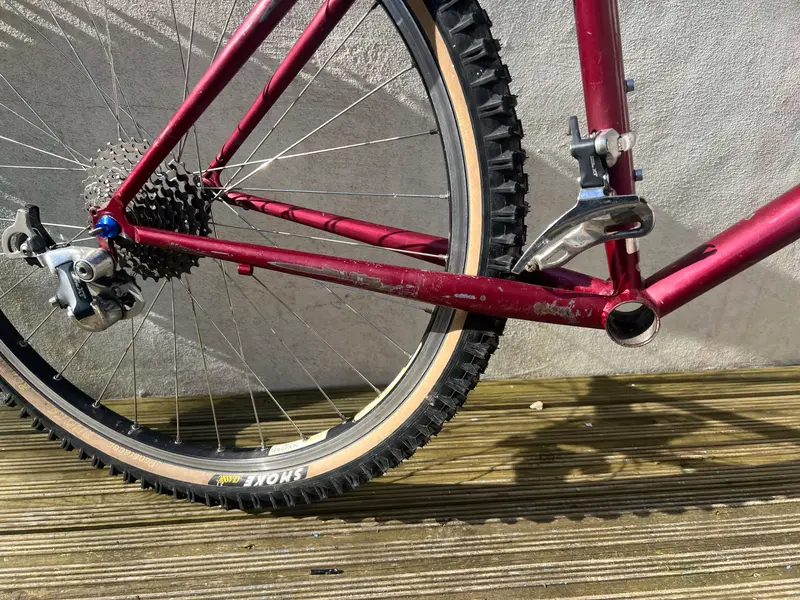

Suns finally out so a few pics of the paint issues. Rub marks from panniers/carry bags are my thoughts. Need to decide on which option I prefer:
1. Prep metal and touch up
2. Prep metal and lacquer the exposed metal.
3. Get a respray done professionally
4. Do a respray myself
I’m not really wanting the bike to turn into a minter that I’m worried to scratch. I have my Diamondback TT as my stock minter.

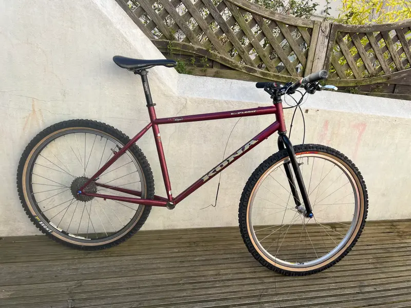

wooohhooo seatpost is fully removed and the replacement (sudden eBay purchase) installed. Also completed some emergency touch ups.
I’m usually a 17 inch kinda guy but with this being a 19 I’m loving how much of the post is showing for some reason?

Personally, I think I’d do whatever is necessary to protect the paint damage from worsening/the frame from corrosion and use that as is. It’s only original once, and if you find later that you really love it you can fork out for new paint I guess.
