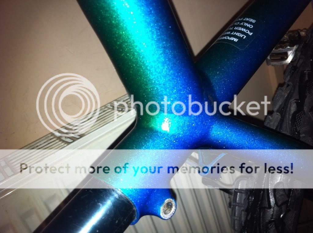

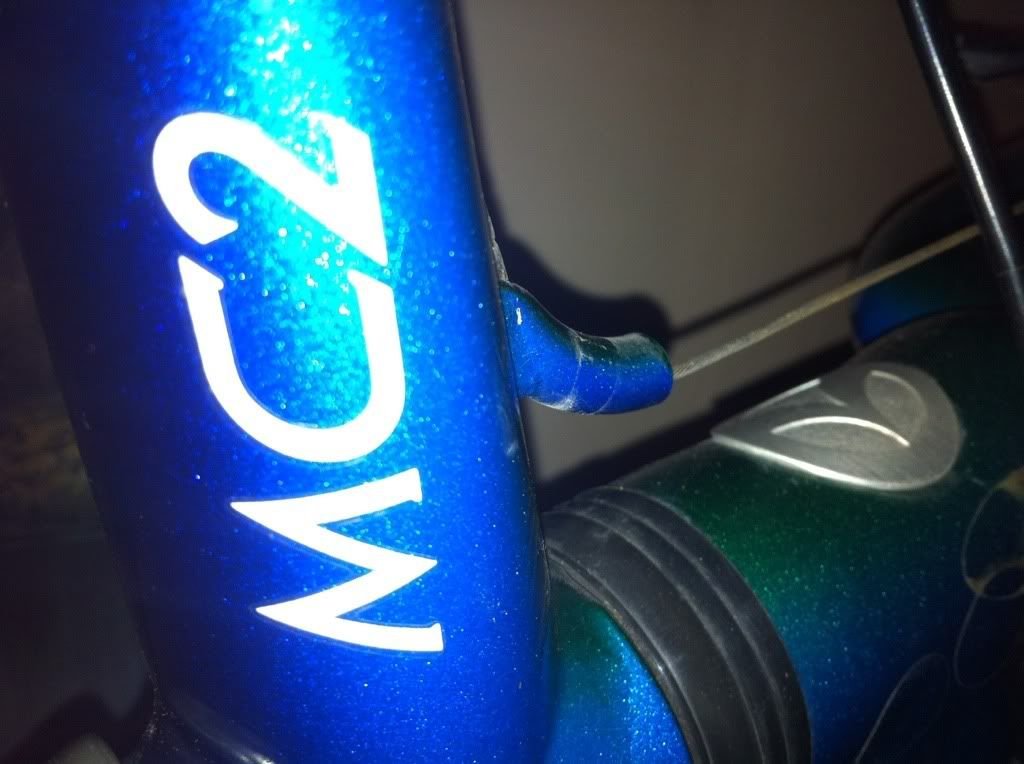

No update as been trying the post tonight.
So instead a couple of gratuitous close ups.
Thanks Mikey.

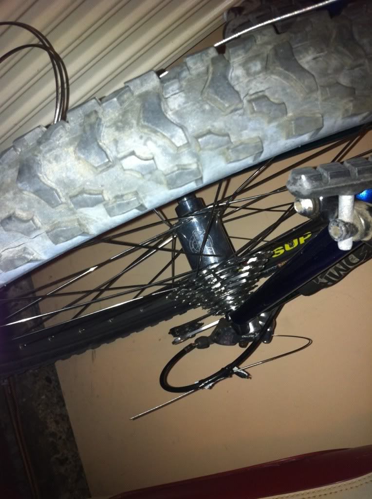

Also thanks to Antstark for truing my wheel.
Another step forward a W.I. Rear hub with a Mavic 517 SUP rim laced up with DT's. Also a XT rear mech and 8 spd XT cassette.
