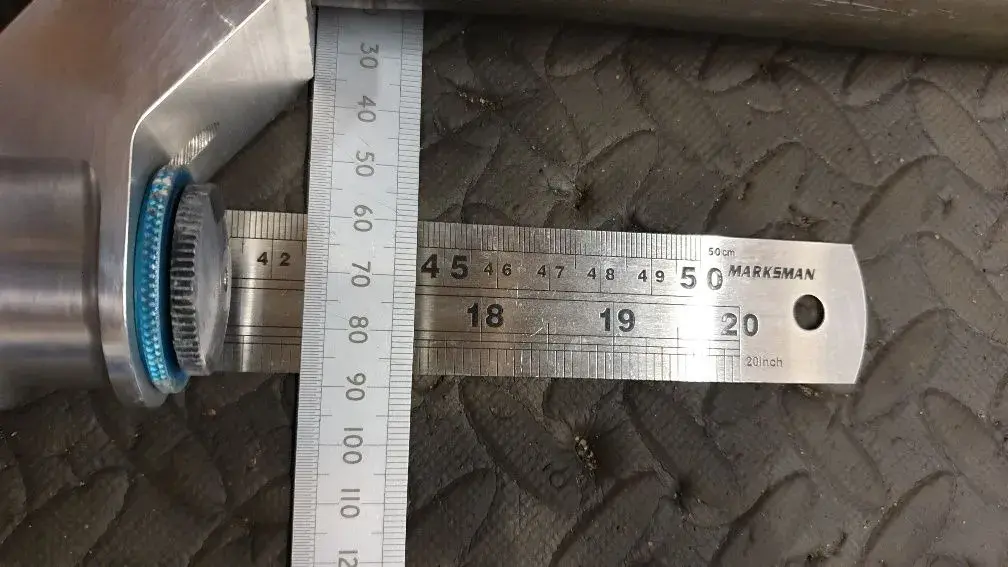

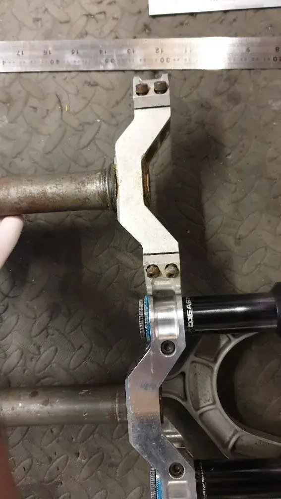

Okay so good news... my Mani 3 (gathering dust) comes in at 420-425mm A-C, I'm pretty sure the crown you see them with is the correct one, however the other crown you see pictured which is spare and can't remember which mine came with (twin bolt clamps) is actually 5mm shorter in overall length... so all that said, your Judy SL's should work fine as they have same A-C as Mani 3s. I've recently serviced 2 sets of '97 Judy SLs and MUST recommend if you haven't already, give them a service and swap up the damping oil (depending on your weight) so something fresh and thicker, I run 10wt in mine (think they come from factory with 7.5wt). It makes a HUGE difference to their performance imo... if you want talking through a service on them then PM me and I'll talk you through it, it really is a doddle and tonight's that I serviced took me all of about 20-30mins :), unless you are local to Nottingham and happy to lend a hand if needed :)
